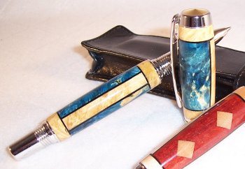

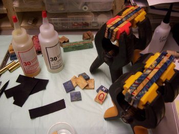

Hi Randy, I think everyone fights the glue lines, me, I just work my designs to hide the glue! Instead of mating two contrasting colors together, I work in a black or other dark veneer as part of the design as Hank suggested. Once finished, I doubt anyone looking at the pen can tell where the glue stops and the dark veneer starts.
Just something to think about.
Here is what I'm talking about....note the black veneer strips.
Here is how the pen looks and I think the veneer adds to the look.
