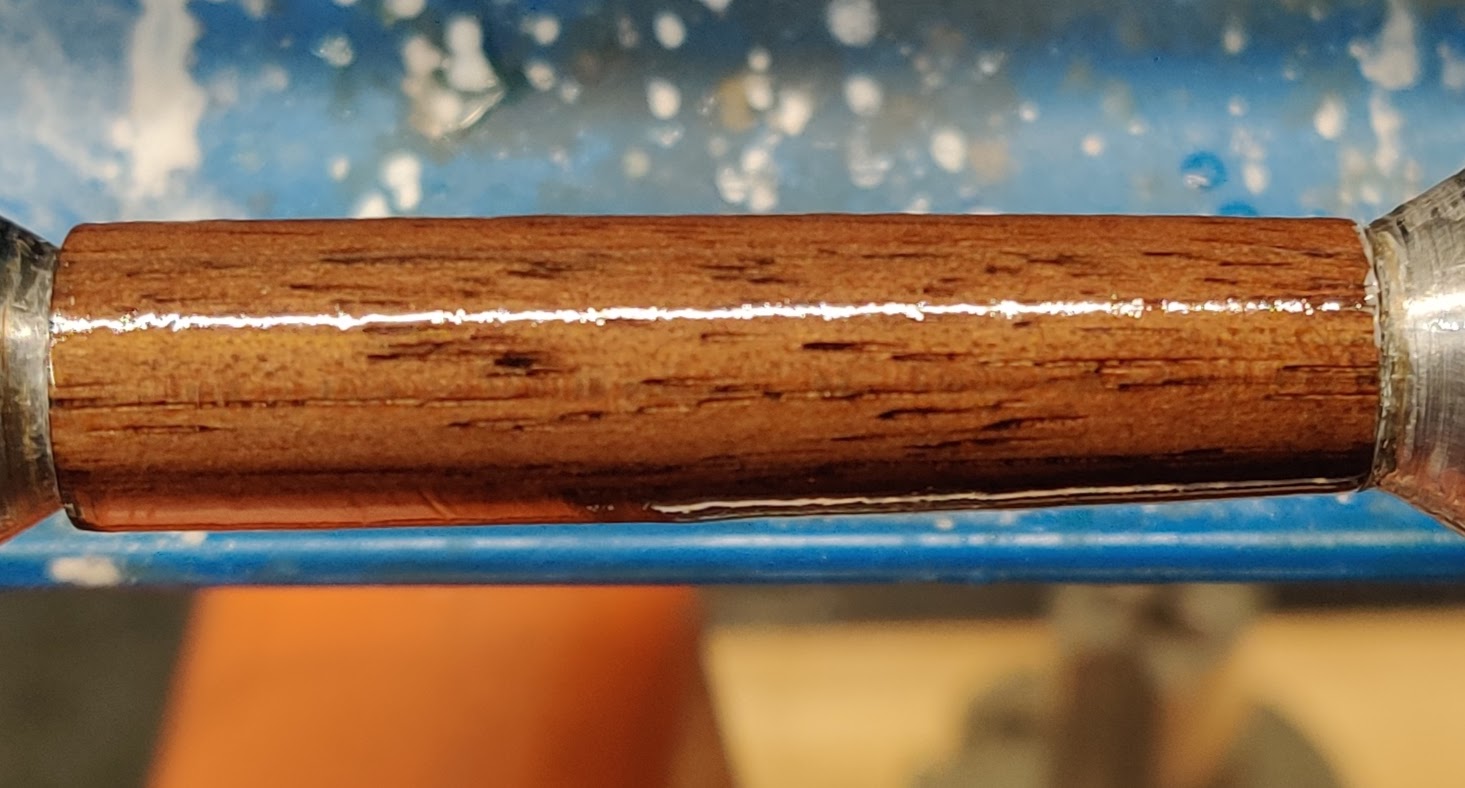

Ok, an update. Tonight, I put some coats of both blue and orange on this blank. This is the pair to the cap that I tried putting a Danish oil base on, so this also has a danish oil base (I think that helps bring out the chatoyance in the end, although so far the best chatoyance was with a walnut oil base coat).
I did several things differently this time:
1. Used a new applicator I concocted: foam with wax paper glued to it. The foam clearly caused a problem on its own last time, but pure paper towel doesn't seem to be any better...the wax paper seems largely immune to the glue and doesn't seem to introduce any junk of its own.
2. Brought the glues and gludry inside last night. Its 70 in here.
3. Used gludry in the way Ed recommended over the phone (and I think also recommended by John U. and another member here): Sprits once on a coat, and then do several more before spritzing again. Also spritzing at a distance of ~15" on recommendation of the GluBoost team.
Humidity was not high, but not low, at 45%. It definitely wasn't near 70% and was not over 80%!
First few coats went on great. Lathe on, spinning, at 1000rpm. This may be too high, this is something I'm considering as a factor of my "grabby in 3" issue. I may drop the belt to a lower gear ratio. Clear, just a little bit of rippling. These were coats of blue. Did gludry on the first coat, not on the next two. With each coat, I just didn't seem to have enough GB on the applicator (used two small drops), it seemed to get yanked off the applicator and onto the blank in an instant, and usually only seemed to cover about half the blank. So each time, I had to put a bit more GB on the applicator and coat the rest.
Q1: What, exactly, is a "drop" to those who use GB? Maybe I am just under-estimating how much is needed here?
Next coat, also blue, started to get grabby in about 5 seconds. It grabbed a bit right at the left end...I let it spin, which evened out the lines a bit, but still left a notable mark at the very end, before I blasted it with gludry. Let it spin for a bit.
Did a coat of orange (thin). This stuff was off the wax paper applicator and onto the blank the moment they touched, and it only coated about a third of the blank. Spreading back and forth it got grabby in a few seconds, and still hadn't coated the blank. So I put...well, probably several drops on the applicator (and this stuff wants to drip off the applicator really easily) and was able to fully coat everything. Clearly too much, ended up with "beads" at both ends of the blank. I tried a couple of VERY quick dabs to try and even that out, which seemed to work. Quick blast of gludry.
Couple more coats of thin. Both got grabby fairly quickly. Maybe this is the gludry doing its thing, as others have mentioned, it seems to work through the coats. Still, watching people's videos, open time seems to be more like 10 seconds or so, and I'm at most getting about 5.
I am really wondering if my RPM is too high. I think before I finish coating this blank, I am going to adjust the belt and see if a slower speed helps. I'm curious, what speed do most of you apply with? That said, I did have problems with this stuff not spreading and getting sticky and grabby even with lathe-off manual application, so, maybe I am still grasping at straws.
FWIW, I had completely exchanged the air in my garage last night. I opened the front garage door about 6", then used my shop fan (which has a very high RPM and high CFM of air moved), to exhaust it out the back door. Just in case there was something wrong with the air. I gained maybe two seconds of application time, which with the need to reapply some drops of GB to the applicator each coat, didn't really buy me what I had hoped.
Ed @ Exotic Blanks has shipped me some new GB bottles. Hopefully, they will do the trick.

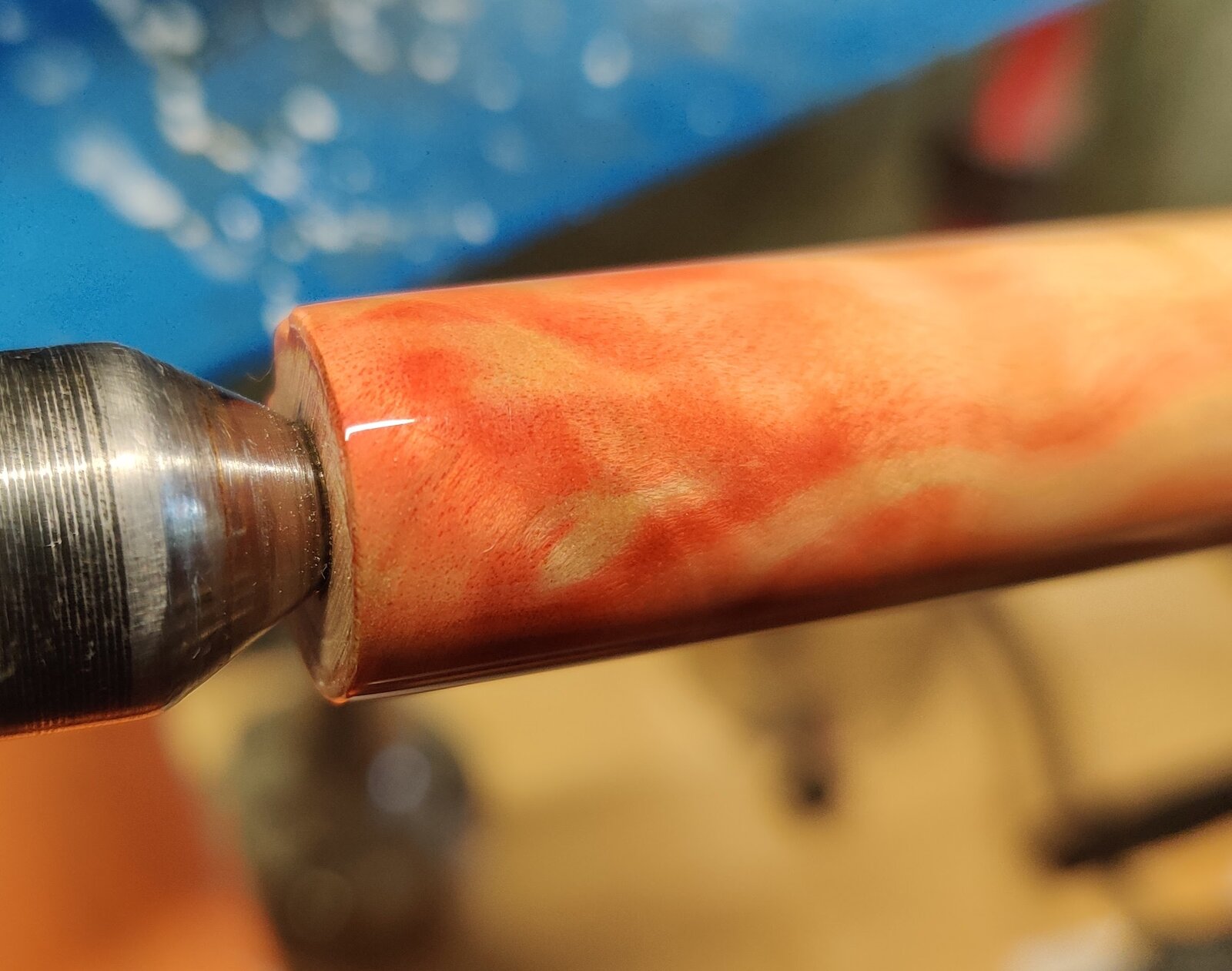

Alright, well...RPM may be a factor. I dropped my lathe down one belt position (was on the highest, now in the middle position). Used the lowest speed setting, which for pens, is pretty darn slow. Manually applying a few additional coats of thin, I did not need much at all, and it seemed to go on ok. I didn't seem to need more than about 8 seconds to get a few back and forth swipes in, and things seemed to clear up more and more each coat.
I still have a few blanks to test with. I'll turn off the existing finish and play with them more tomorrow, but hopefully at this slow RPM, I'll have the open time I need to use significantly less GB in each coat, and hopefully I'll get clearer, cleaner, smoother coats that don't need much sanding back (even this blank I just did, is going to need a decent amount of sanding to smooth out all the ripples.)

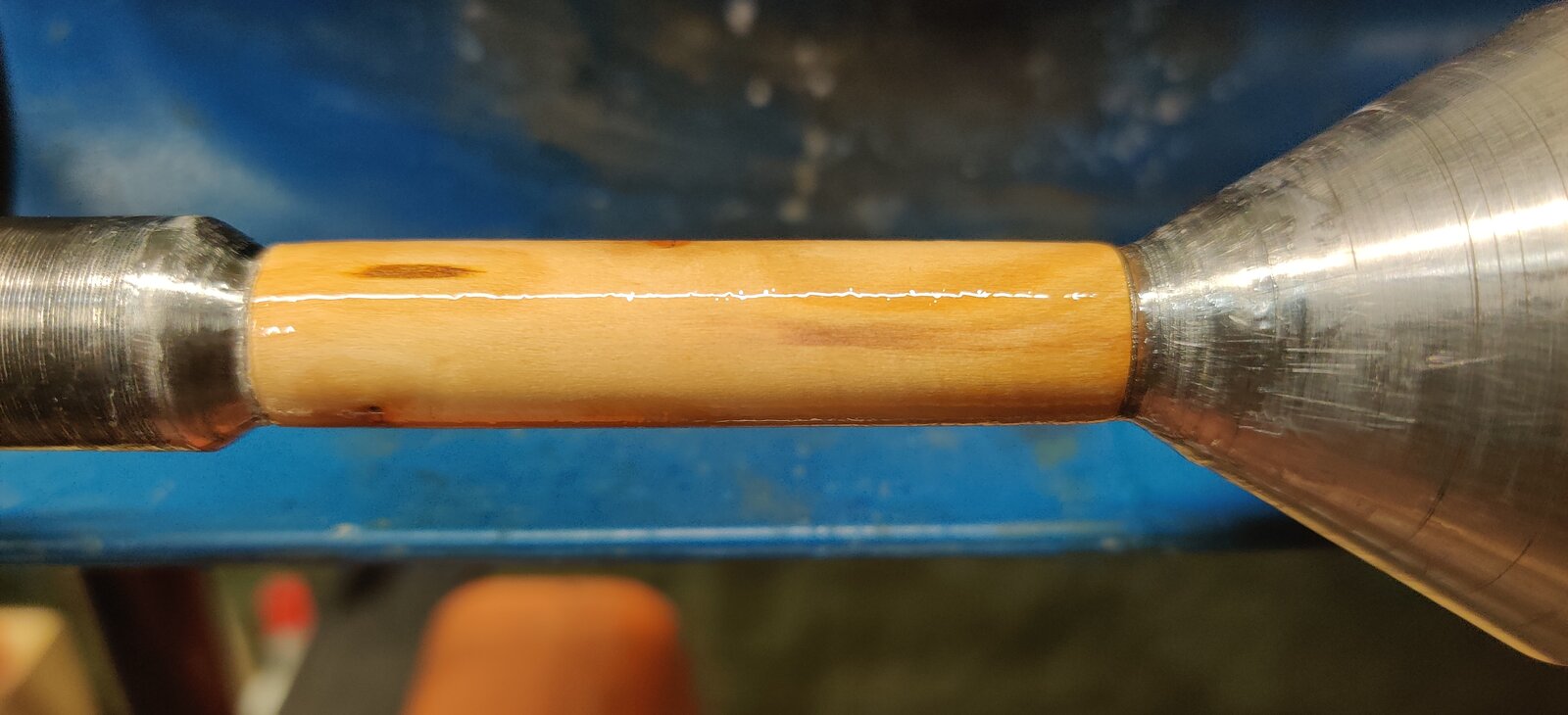

Well, today's update. Been playing with the old batch of glue again. I'm pretty sure its bad, somehow. Humidity started off at 25%, and I thought that would be perfect, that things should go swimmingly.
Well, one thing that has improved is that at the lower RPM, I DO have more working time. That said, this stuff is still drying dull and frosty. The coats are much thinner now than they were before, however I still don't think this stuff is drying properly. It starts out looking clear and shiny, but once it dries (either by the air, or gludry), its dull and frosty. I suspect at very close inspection, it would still be wrinkled, just at a finer scale.
This started at 25% humidity. That has increased to 34%, and a thunderstorm has rolled in. Still, 34% is very low. So, I don't think that I'm the problem anymore...I think there is something wrong with these bottles of GluBoost, or maybe something about these blanks, or maybe something about this peruvian walnut (I bought a board of it some time back, and have been cutting blanks out of it for a while now...maybe there is just something up with this wood???)
I haven't yet tried the new stuff from Exotic Blanks. I have another blank I'll be pulling out for that. Hopefully the new glue will be better. If not, then its gotta be the wood, or, maybe my hygrometer is bad, or something else environmental.
I will say, I am glad that I'm able to get on such thinner coats now. I felt I was using a heck of a lot of glue before. Now, I feel like I could at least be efficient with this very expensive finish.

jrista
Aug 12, 2021
2,256
Colorado
Latest pen finish. Looking pretty good so far with three coats of the orange, and 4 or 5 of the blue. According to my calipers I still need a bit more (overturned this one too much...gotta work on that...) to get back up to the specified diameter of 0.482", but I'm almost there.
