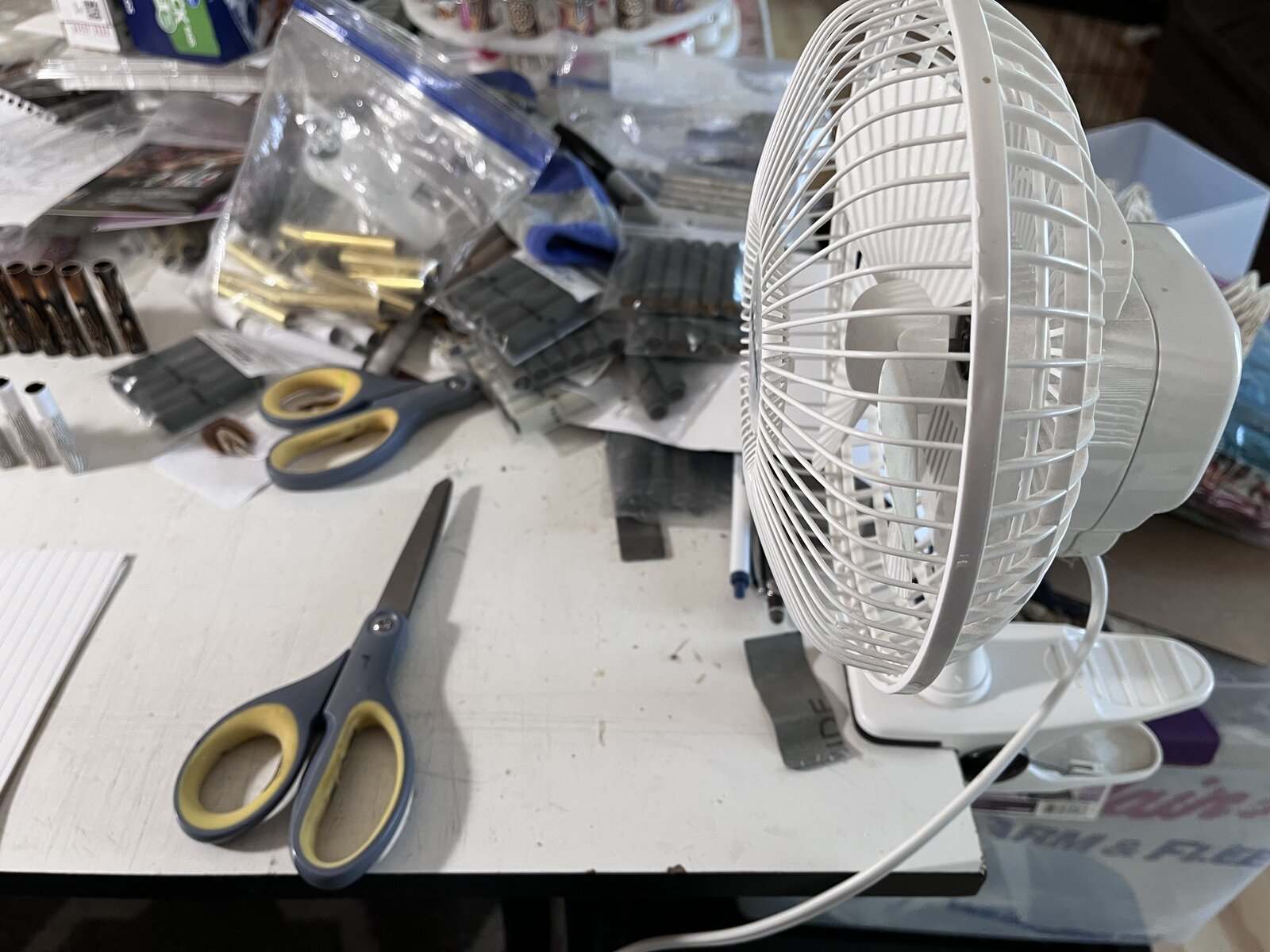

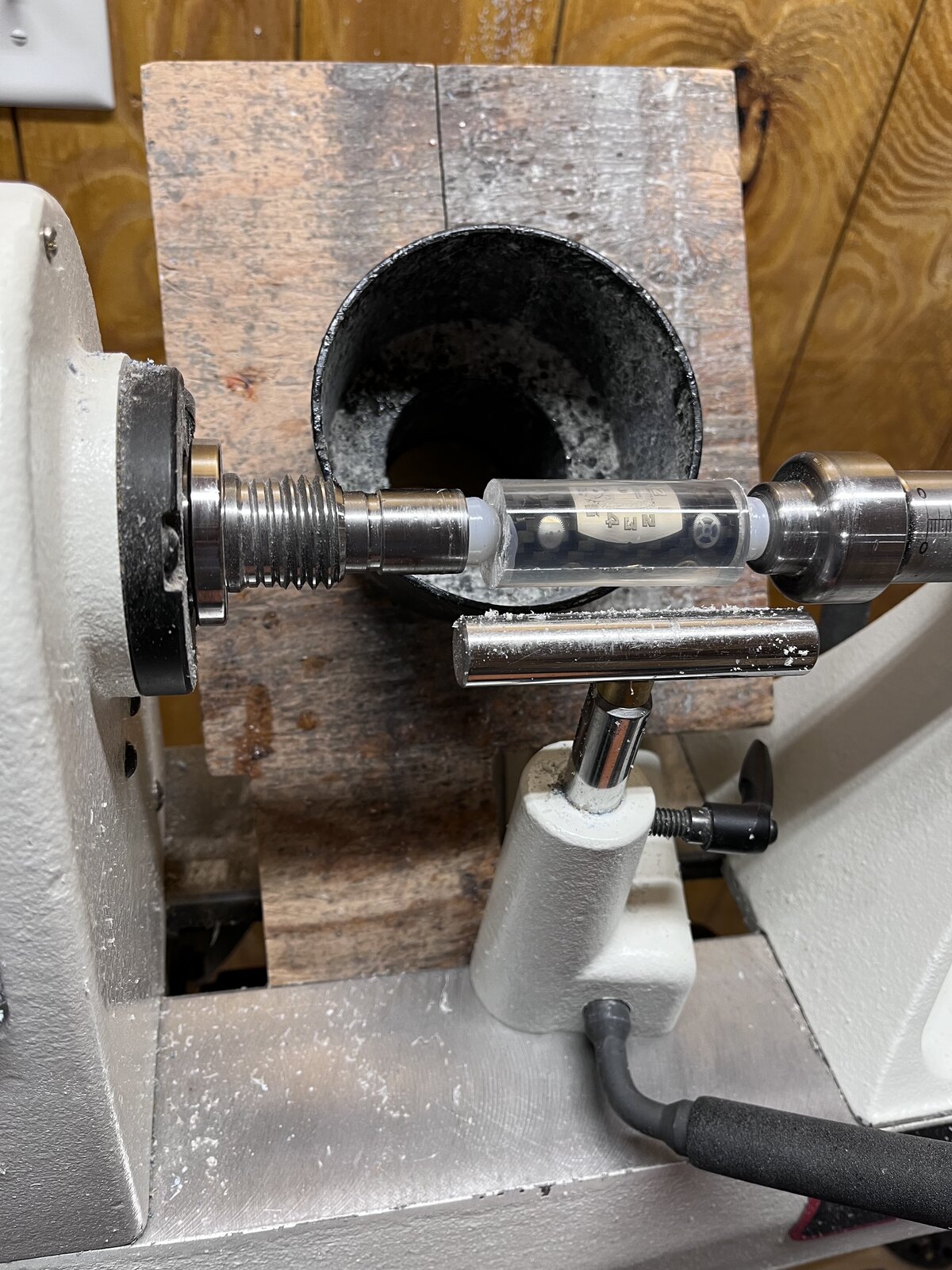

I run my vacuum behind the blank, when it's on the lather, to pull the fumes away from me. When I'm working at my blank making table, I have a small fan that clamps to the end of the table and blows across the work areas.

How close to your blank do you get your intake? I currently have this Rockler pen intake scoop on there, and i actually can't get it too terribly close. Maybe I need to take that off, and get my intake closer... I guess covering the intake with some damp cloth might not hurt either, that should help nullify the fumes too.
Mines a couple inches. It's a home made thing out of scrap plywood to hold the vac hose. The fan could be used on the lathe also. It just clamps to a surface.
