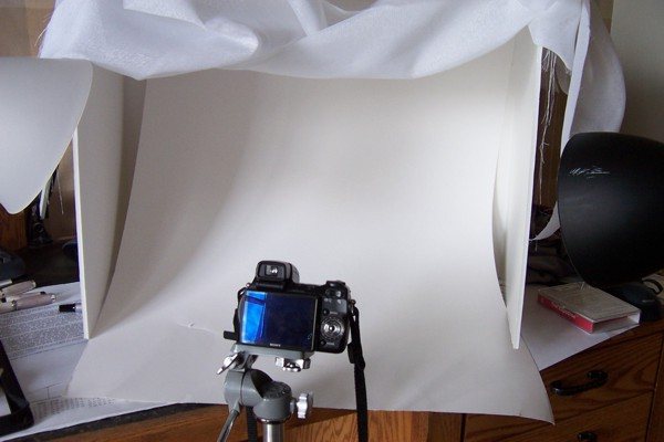

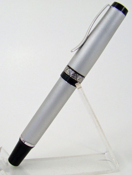

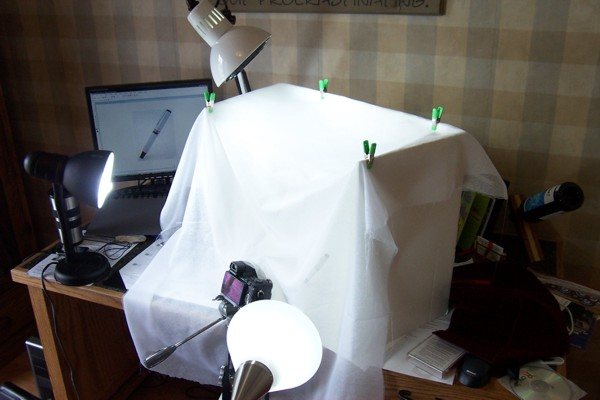

Here is a picture that I took using Gerry's tutorial. It is an aluminum El Grande that has been glass beaded. No other finish on it. The picture shows the light tent I used with three 6500K bulbs. I used the 18% grey card to get an exposure of 1/40 at f8. And, I used my expodisc to set the white balance. I tried the auto and a couple of the flourescent preset white balance settings, but they didn't work.
I plan to get the plexiglass and 5500K CFL bulbs that Gerry recommends.

That's good work Steve ! Looks to me like you've nailed it . I too read Gerrys tutorial . I really needed to !! Thanks Gerry ! No , Thank You Very Much !! I will read it again and again , until I get it right . [8D]
