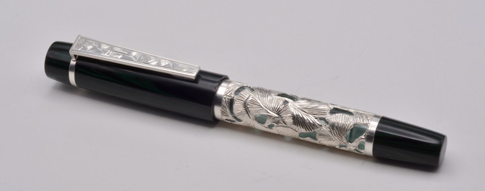

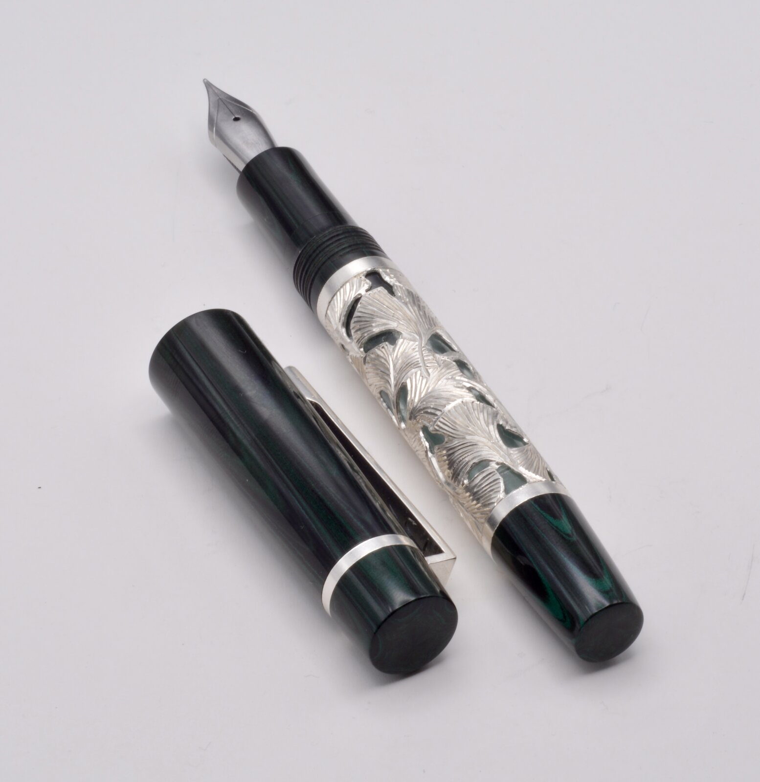

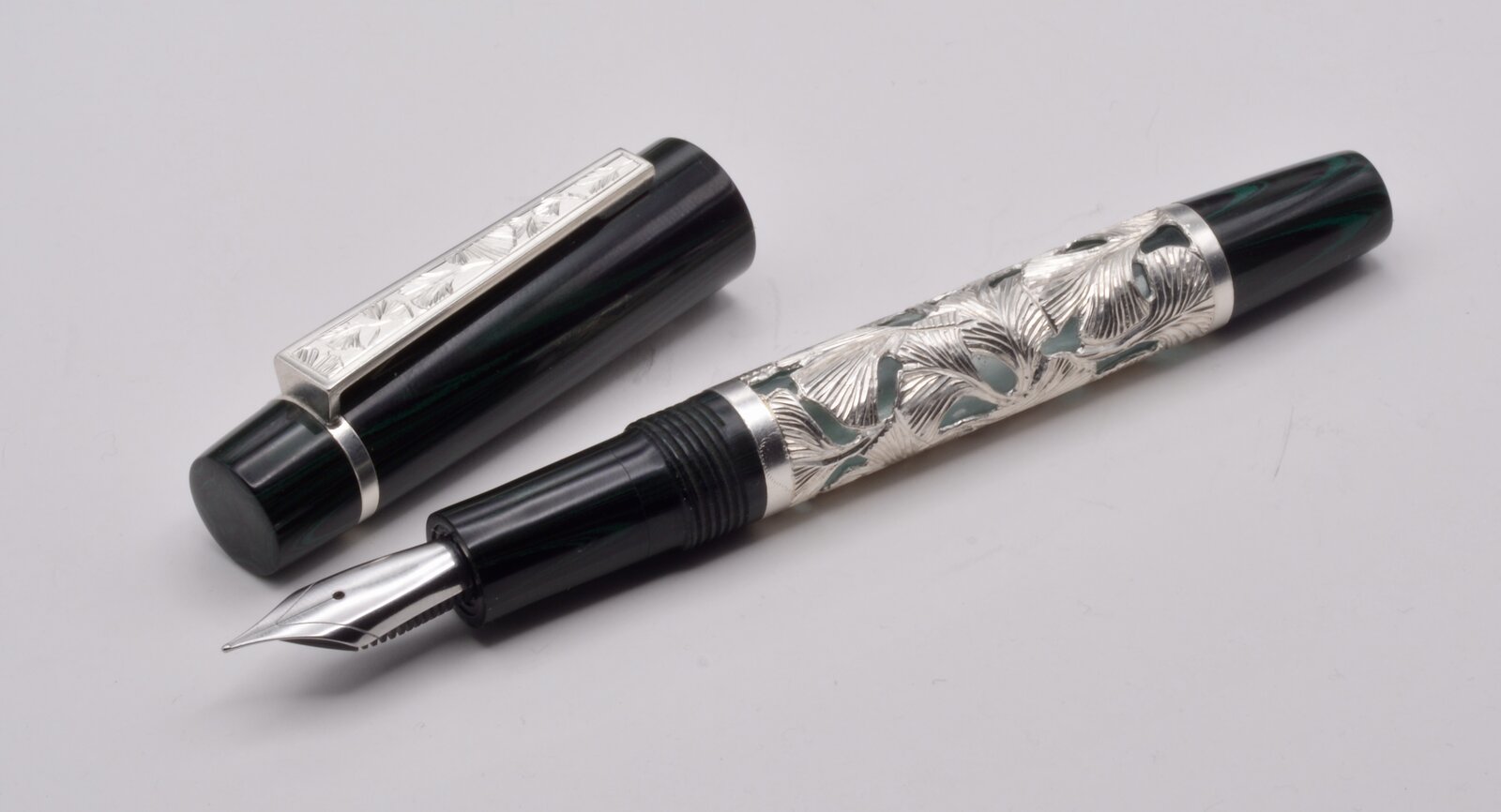

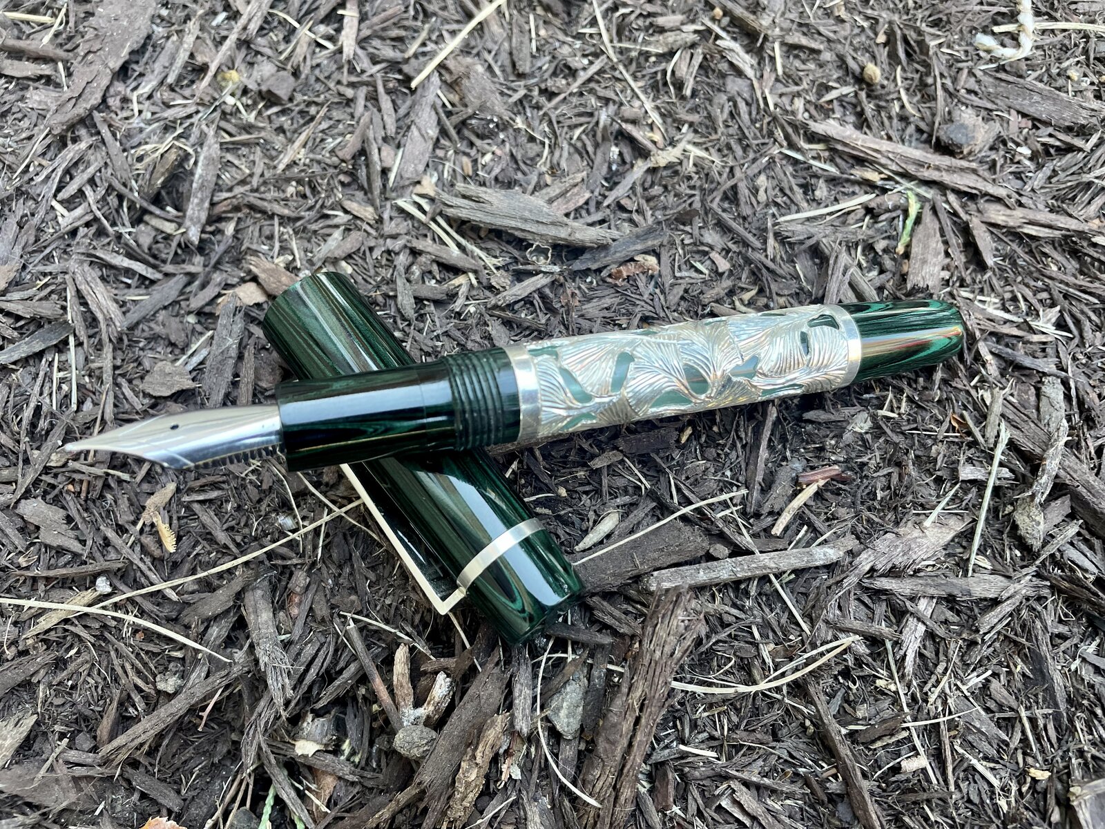

Here is a pen I have been working on for a few weeks. I made it from Nikko ebonite and transparent blue/green acrylic, with Argentium silver overlay and clip. The overlay and clip have a ginkgo leaf motif on them. I skeletonized the negative spaces in the overlay because I like the effect of it on a transparent barrel. The pen uses a jowo #6 nib, and has a max diameter of about 13mm at the barrel.

It started out as a piece of flat sheet, and I rolled it around a piece of steel bar stock and soldered the seam to make a tube .

I rolled up a rectangular piece of silver sheet and soldered the seam to form a tube. I then laid out some leaves on it with a sharpie, and engraved them into the overlay with my pneumatic-assist hand engraver. Once I had all the leaves engraved I pierced the negative spaces between them with a small drill bit, then used a variety of burrs in my foredom tool to open up the negative spaces and refine them.
