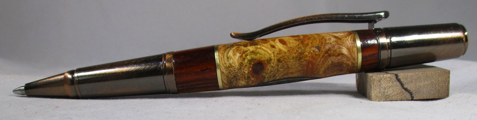

I recently made a pen with a cross in front of a stained glass window ( a @mark james copy/knock off, though with his encouragement )
My neighbour ordered one this morning, said she needed it this afternoon as it would be a gift for the minister's wife.
This is what I ended up with as I had a blow out at one end.
Sirocco kit from Beaufort Ink.
Dressed with cocobolo, elm, and frogwood.
Alan

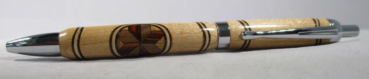

This is the second time I've seen this design done (I believe the other was made from one of Mark's blanks), and in both cases I've been impressed, but puzzled by just how it works. How do you (or Mark) get that ringed oval insert with the "stained glass" in it?
Alan Morrison
Jan 15, 2019
3,104
N Ireland
It's cut from the blank using a hole saw and the thickness of the kerf filled with three layers of veneer before glueing in the corresponding portion cut from the 'stained glass 'piece with the same hole saw.
If you look in my 'media' photographs there are a couple of photographs showing this, or better still, check @mark james previous threads or his excellent descriptions which you can find in the resources library. ( if I knew how to put in links I would !!!)
Hope this helps, but if not just contact me again
Alan
Bats
Oct 12, 2020
364
W. Nowhere, CT
All I've been able to find in the library is the cross (which interests me less - me & crosses never really got on too well) in a rectangular frame, rather than the oval one I was puzzled by, but I understand now... I think?
If I'm interpreting the pictures in your media right, it's basically hole-sawn from the side (cross-wise from the face of the design), using only the side (rather than the entire diameter) of the hole saw, with layers of veneer laid down in the cutout?
My problem was that I was thinking it was drilled from the top, and couldn't figure out how to make an oval design/outline, aside from maybe drilling the hole diagonally and then wrapping the (also diagonally cut) plug tightly with steamed veneer (trying vainly to avoid a visible seam), then somehow attempting to mash the whole mess into the hole. Your/Mark's way, on the other hand, looks like it would actually work.
Alan Morrison
Jan 15, 2019
3,104
N Ireland
You've got it ok.
If you go into 'Search' and type in 'Picture Frame Inlay -#1' there is a thread from @mark james in which he has lots of photographs showing the process to make the oval window design. You need to scroll down right to the bottom of the threads as the pictures are all through the different posts.

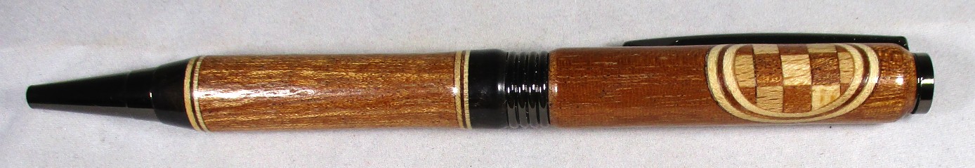

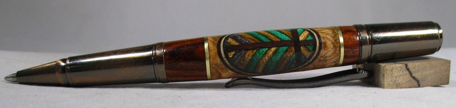

The jig that Mark uses is a bit more 'high tech' than what I use, but I can send you a photograph of my set-up if you wish.
Hope that you find this useful, and you should 'give it a go'. There is no limit to the different designs that you can fit into the window. My media photographs show a few early noodlings.
Alan
