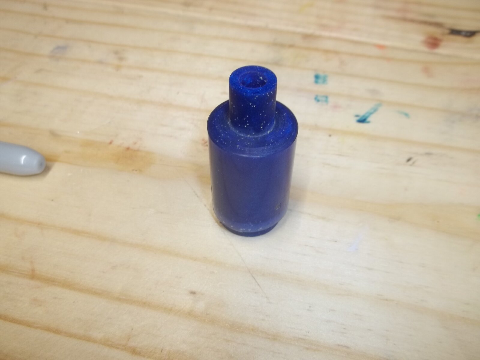

I finally decided to get into casting. I hope to make embedded object blanks for sale. I didnthe sampler pack of pearlex't know what colors to choose so I got the sampler packs of pearlex and alumilite dyes to start with. I also got a few individual colors for ideas I have. In order to see the true color of resulting casts, I made 1 oz samples of each color using 0.006 oz of pigment for each. Some of the samples are so dark that they appear to be black when thick. I intend to turn a hollow tenon on each to see what they look like when thin. Here is a pic of my color board and the first sample that I have turned.
