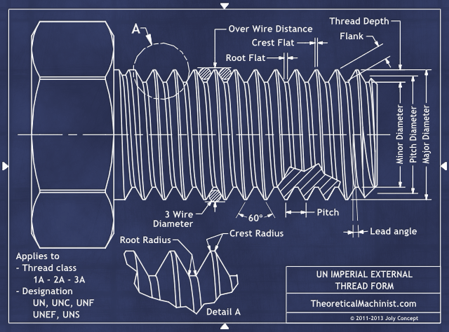

When you start cutting your threads you're going to want to do a good bit of research on all the measurements. Often in "kitless" pens you'll need to cut external threads on a piece directly above where you cut internal threads. Knowing how deep the threads will cut and how tall they should be will often make the difference between a functional pen part and a miniature slinky. (yes, that's experience talking) Of course, trial and error works great too, just be sure to make a log of what you do so you can reference what works and what doesn't later on.
Google is your friend. figure out what your dimensions are for the thread you're cutting, what the minimum and maximum depths are. You'll also find some interesting differences about what size to drill the hole actually depends on the materials you use. Some need a bigger crest flat for friction or expansion. Other applications may need a smaller crest flat for contraction. Some materials will give and flex, like wood or plastic where as aluminum for instance won't... (by comparison)
Tap Drill Chart
Charts like this are great for reference. Don't be afraid to use the decimal equivalent for a standard drill bit when you're cutting metric threads. I got a large drill bit set from Harbor Freight or Northern Tool (can't remember which) that has every letter and just about every fraction (except of course the ones most kits ask for). This comes in very handy when I'm looking up the decimal equivalent for fractional mm.
Hope this helps with the thread cutting questions. Those were some of my biggest unknowns when I first started too.

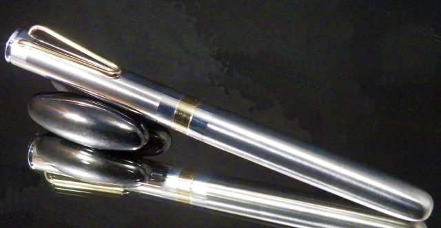

Yes it is good to see you Butch and sorry to hear about the shop. Many people I know are still trying to recover from Sandy and a few are still fighting the government for their simple share of the money.
By the way take your time and get the shop the way you want it. I will take care of some of the Bash contests this year. Thought i would throw my hat in the ring on a few this year.
Glad you showed your pen with the use of a simple wood lathe. I try to tell these people a metal lathe means nothing if you do not know how to use it. So much can be done with a simple wood lathe and wood turning tools. CNC machines and huge lathes means nothing to me have no desire to own them.
