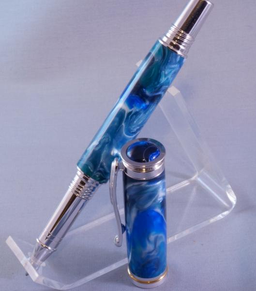

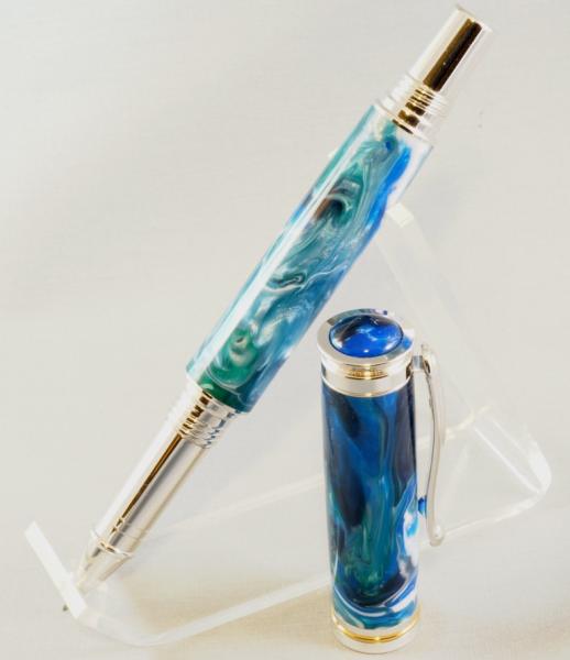

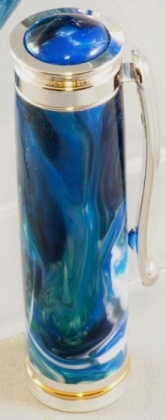

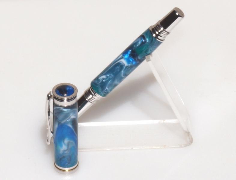

I really struggle getting anything better than just average pictures. So today, I set up my light tent, and read the manual for my camera (again:bulgy-eyes:). And I think I finally understand how the light balance thing works. My big problem before was getting colors to look right when I was in aperture mode. And I really wanted to get my depth of field to show more detail at the edges. And still give accurate colors.
Here's a few pics for comparison from a recent pen.
Old Pic.
attachment.php
New Pic
attachment.php
Close up Old
attachment.php
Close up New
attachment.php

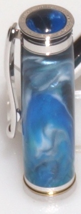

Depth Shot. I moved the cap as far away as I could in my light tent. In fact I got the cap in front of most of the light. That's why the colors from the pen to the cap look so different. I know the focus isn't perfect, but before I've had more focus issues when the pen was capped than I did with this shot.
attachment.php
I know these won't win any awards. But I do think I'm getting a little better. The best thing is that I only took about 10 shots to get the new pics. I'll bet it was more like 50 for the original pictures. At least reading the manual has saved me some time.
Obviously, I welcome any critiques/tips you can give me. My camera is a Sony A65 with a 18-55 zoom lens.

I see improvement easily and you are doing quite well to me. Nice color balance and much better appearance of resolution. What f stop did you manage to get and what shutter speed? I have some software and perhaps many exist that can "see" this info from all of our digital photos if you do not remember.

I don't recall the f stop because I used 3 or 4, and just picked the picture that looked best. I used aperture priority, and I think I started it at 16 and went up. In this mode I can't control shutter speed. I did have to adjust the contrast with software to get the picture where I wanted it. I need to go to full manual to set both the shutter speed and aperture at the same time. I'm going to try that next.
I'm at least getting better results than before. After I get the settings somewhat figured out, I'm really going to work on my lighting.

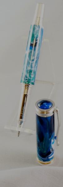

Ok, Things are starting to come into focus (Pun Intended:rolleyes:). This latest picture I used full manual with HRD. The f stop was 32, and the EV was +1. The ISO was set to 100. And while I really don't know exactly what the EV is all about, I think I finally got a picture that looks like the actual pen, and is completely in focus.
attachment.php
I think this picture is a little sharper than the previous one I did earlier today. But the big thing is that the picture wasn't altered at all except to crop & resize. I didn't have to adjust anything as far as contrast or color.
Of course I still managed to clip of the top of the pen. And that was all me taking the picture. I didn't crop it off. OOOPS!! :redface:
But at least I'm getting the quality I expect. Maybe now photography will be a little more fun.

That last photo really captures the beauty of that pen. Bravo!!
You are on the road.

After looking at the picture some more, it really hit me. If you look at the stand, it's the only picture where it looks like it's got the correct exposure. All the other pics the stand looks over exposed. And the background is a light grey, not white like the earlier pictures showed. Well, the original pictures were on a white background, but the rest were done with the same setup as the latest picture. I know I still have a lot to learn. But I feel like I turned a corner on getting better photos.

buy a 18% gray card then set to custom white balance

Beautiful pen, but the new photos (at least the early ones) look like they are two different blanks, like the body of the pen getting more illumination than the cap causing the cap to look much darker.
