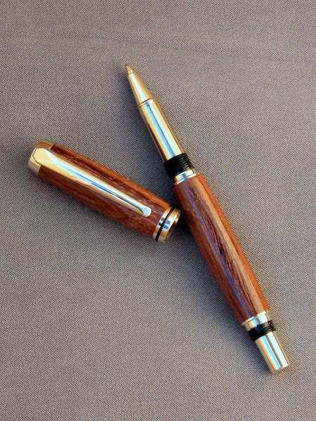

I've been playing with this finish too and the more I use it the more I like it. I don't mind that it doesn't fill the grain. It keeps it looking more like wood instead of the plastic look. I've been using a pen finished with this for a few months and it seems to hold up ok.
Here's a picture of a pen I finished with Woodturner's Finish. This is not the pen I've been using but the finish on both look the same.
I'm thinking of doing a torture test by finishing a piece of wood and throwing it in the washing machine. :biggrin:
