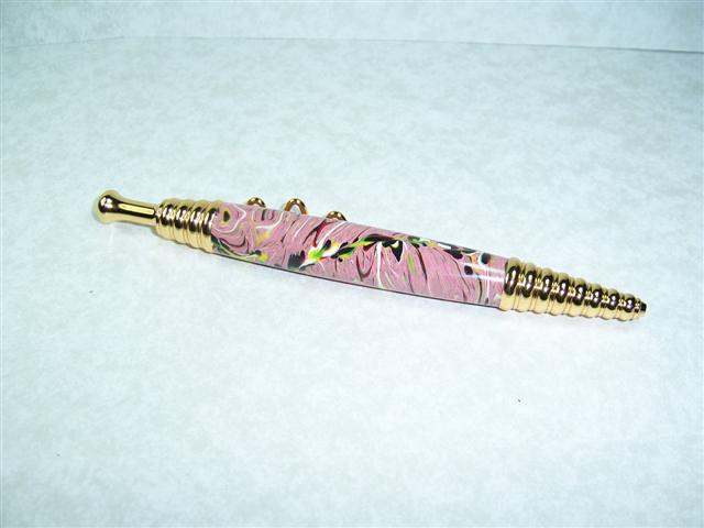

Ok another Sculpey Clay pen' I used 5 colours and Twisted them together then rolled the clay onto pen tube and baked in a gas oven for 15 min at 130c (275f)l did'nt forget to sand the tube'this time. With all these colours l used a Gemini kit' a pen for the girls.also l didnt use the gemini Bushing. l used the Patriot bushing' which leaves more clay on the tube and it work out good.
Then l Wet sand thru to 12000MM then finished with ca/blo.

James l would think it would break! l put alot of ca onit. Jay Pickens has the best way to do it roll your clay thin as possible then bake it.Then cast it in clear resin then turn.then foresure it would be a more Durable pen.[:D]

Mike my grandaughter came around last night and she seen the clay pens!and loved them.She now would like me to make her a Black Patriot with Orange fluorescent clay its no533 Sculpey its so bright you need sun glasses on to look at it. by the way we pay $3.99 for 2oz.[:D]

Great looking pen John, I can see where the kids would love it. Is that pen just baked clay with a CA finish? Did it turn easy? Where there any surprises?

Yes Gary its just clay and lt turns like butter' also be careful when you trim the ends of the blanks they will chip l used sandpaper first' then finished with the pen mill. Then l wet the ends in thin ca like you would for soft timber. then wet sand from 320grit thru 2500 grit then about 8 coats ca/blo then sand from 400g 12.000mm.[:D]

Toni the kit came from www.pennstateindustries.com the kit is a bit tricky to put together at first'and the kit is about the $6 bucks US. with the clay pen' l made a test pen turned it on the lathe to size. l removed the blank from the lathe held it up over my head and dropped it on the concrete nothing happened l done it again nothing' so l threw it realy hard to get it to cracked apart. so l think the clay is stronger than l first thought l will keep on testing till lam convinced the clay is ok as a pen.[:D]
