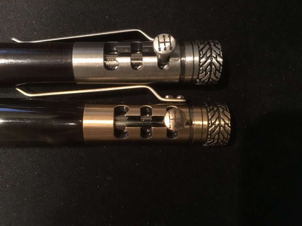

I sold a few...have not gotten any negative feedback. All seem to be fine. The Chrome Gear is a nice pen...maybe a rub with black rustoleum to fill the shift pattern. I do not have chrome to show...sold it for (pm if interested)
While we're on the subject.
Music Pens...chrome least desirable.
Faith/Hope/Love...gold least desirable.

Well I am not a fan of the gimmick pen but as I keep saying I thought i would try them for a guy who loves cars and racing. I could have done a simple carbon fiber but this has a little more appeal.
Frank what is the top pen you show in that photo??? You can see the markings well in that one.
Top is pewter. The antique brass under it has great markings...just a bad picture. Gear pens are real nice close up. Gimmick pens...These pens are absolutely attractive & functional. Certainly not traditional but rather fascinating. I hope they grow on you. There is a lot to choose from. Let your customers & friends be the critics. I thought the skull pen was a bunch of nonsense until I made them. Regardless have fun.

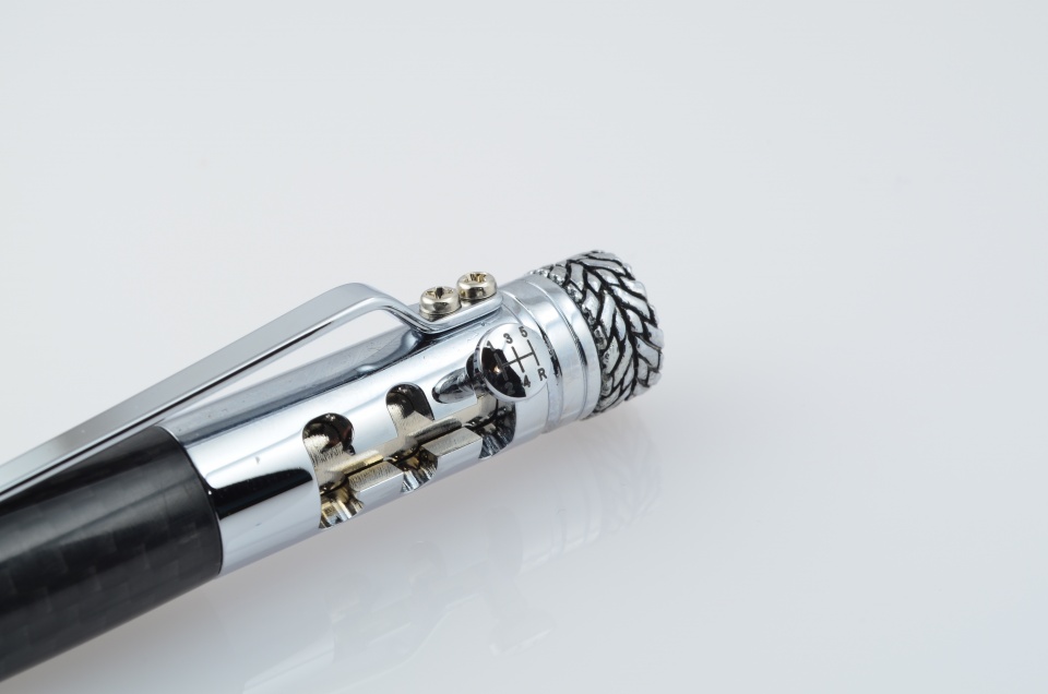

One other question Frank being you have done these. From all the photos in catalogs I see, on the chrome kit it shows the flutes on the nib end to be blackened. Is this a reflection of the light when they took the photo??? On the pewter they are clear is that correct. And the bronze are they clear??? I like the black. I assume the tire treads are blackened.

The pewter & brass flutes are highlighted with black. They stand out. I'm sorry I don't have a chrome to compare but the other two are outstanding. You will like these kits. They are well made, very classy & novel. The other thing I like is it's a one piece tube kit. If you do not like the kits simply ship them back for exchange. If you are currently working on the blanks and need bushing measurements to get them Roughed In I can provide the size. Also if you want the actual size of the blanks after they are squared I'll give you the measurement I have. Best bet is make one and see how you like the length. You're gonna like these kits... I guarantee it (sounds like Men's Warehouse)

Good luck trying to fill the shift pattern etching on the chrome, it won't work. The problem is they etch the patter before plating, and the chrome then fills a lot of the engraving. There's not much left to fill. Stick with the brushed pewter for this model.

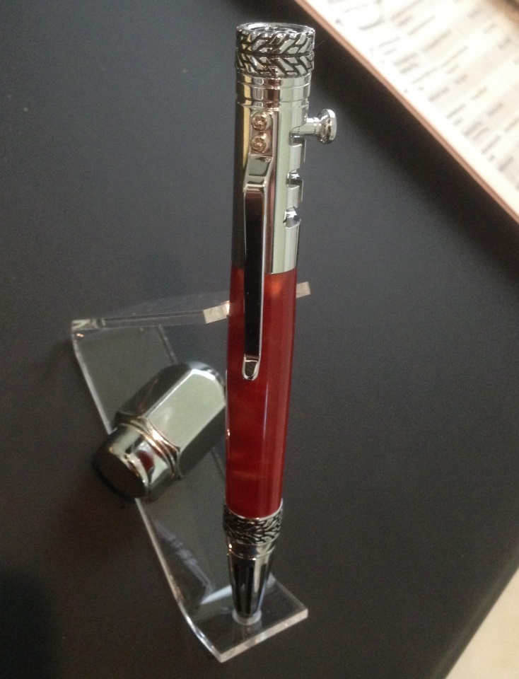

Here is a picture of the one I just finished yesterday, I don't know it is shows the shifter well enough, but it is still visible, and it is the chrome version.

Thank you Dan. From your photo the gear shifter is very clear in reading the markings. Maybe the light of the photo but to me it seems there is some blackening of the numbers. Am I wrong??? Is it possible they made an improvement or are there more than one maker of this kit???
I will find all this out shortly when I get my kits but it is nice to see.

It is definitely the lighting of the photo, and not on the pen itself. I didn't take the picture specifically to show here, but just happened to have one that showed the shifter.

Good picture, and you got one of the "good" kits. About half the chrome gearshifts I ordered have very little if any of the shift pattern visible on the knob. On those, you can clearly see where the chrome plating has erroded and filled the etching.
