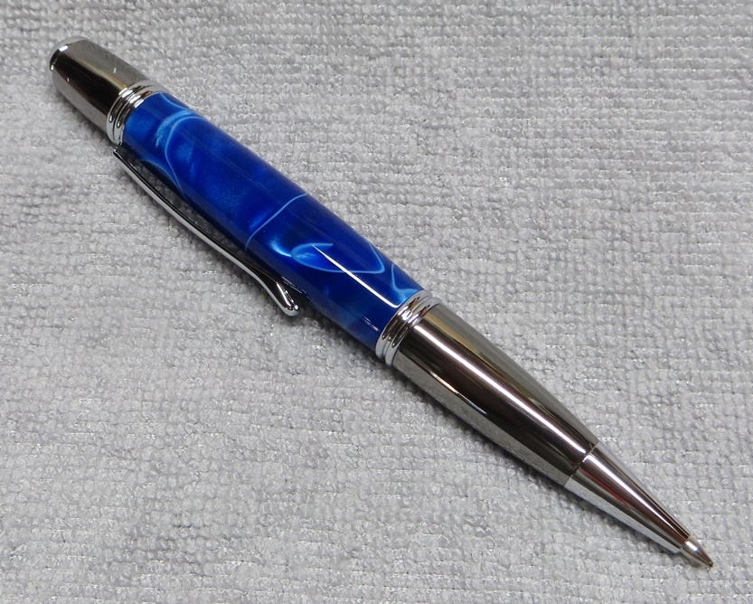

I am having an issue with a Gatsby twist. The refill is not extending far enough, it barely clears the end of the nose cone. The tube measures out to be the specified length. The refill moves in and out of the nose cone freely. Refill is the right length. I am going to swap out the transmission to see if that makes a difference. I would rather not knock it apart and shorten the barrel but may have to.
Any thoughts on what might be the problem?

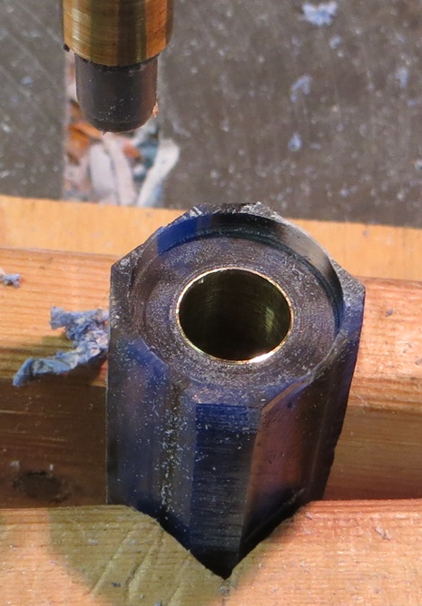

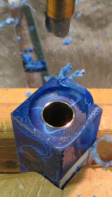

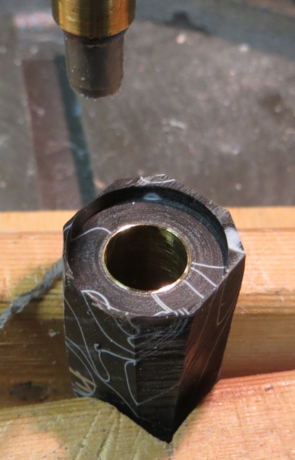

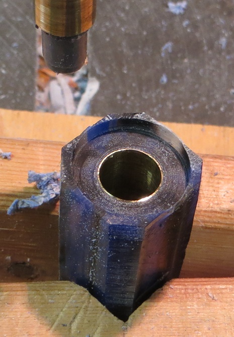

It sounds like you maybe didn't trim the blank enough. I trim til the tube ends are shiny, and haven't had a problem.
I trim until the metal is shiny as well.
