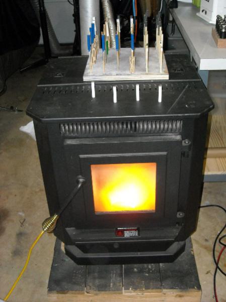

I live about 45 mins South of you near Draken, I too have a two car garage that is not insulated. I use a wood pellet stove, it heats my shop the entire Winter for about $170 in wood pellets. It does such a good job I literally wear shorts most of the time while in the shop and open the garage door to heat the first floor. If you would like to take a look, let me know.
Michael,
Here is a pic of the pellet stove I have in my garage that I use for my shop, it doesnt take any room and is eco-friendly as well as economical.
