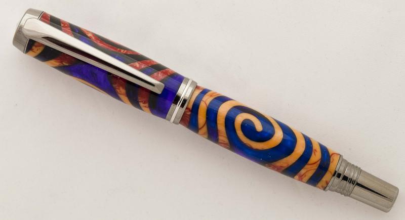

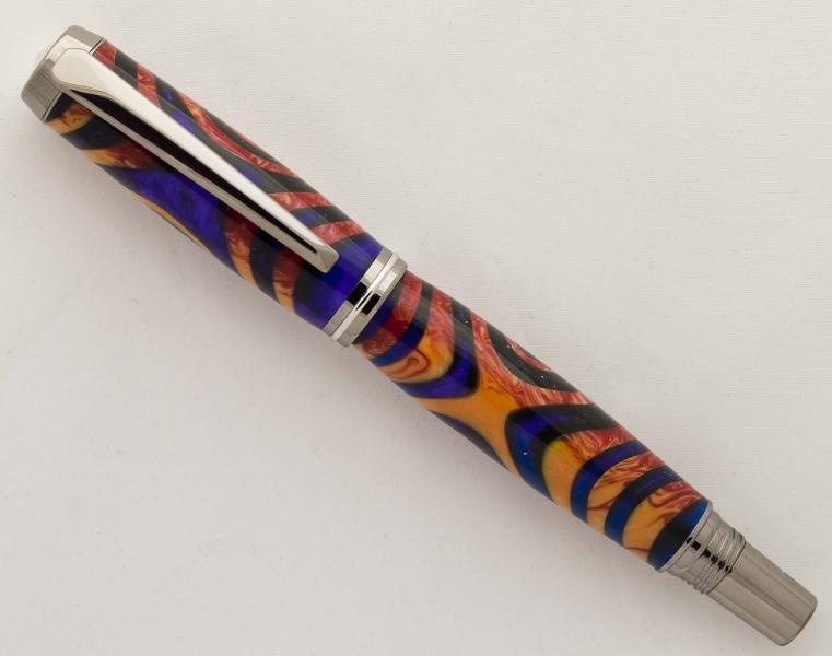

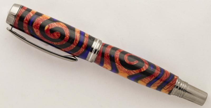

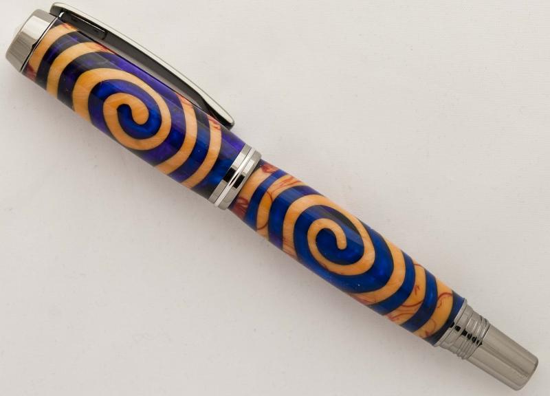

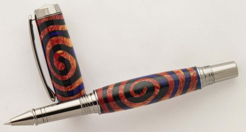

Made it this A.M. It's a Jeff Powell Blank I got from Exotic Blanks called Fun House. It's definitely trippy.. It's on a Black Ti Jr. Gentleman. Not completely happy with it as I feel like I overturned the barrel section a little.:redface: Think my bushings may be a little worn. :rolleyes: Comments welcome but most of all thanks for looking. Doc:)

After snapping out of my hypnosis, (love the pen) I could barely see what you are talking about concerning the body. Can you put the body back on the mandrel and add a few more layers of Ca to bridge the space? Not very noticeable, but I know it bothers me when I hold a pen I've made and can feel a little catch at the junction points.

Looks awesome! I love how both sides of the pen are different colors. I do see how it looks just a hair over spun. It is ok to apply a CA finish to these pens, as they are alumilite which will accept the finish if the user wishes to do so...but applying a finish will take away one of the great properties of the material..it's flex and strength, making it more brittle. It sure is trippy. In photo #3 is there a nick out of the finial?

You've got a decent taper on the tube, so a few passes on a sanding mill (with a digital caliper measurement as you go) and you should be able to bring it back to the right measurement without loosing more tube length than the spring can make up for, assuming it has not already been shortened some...

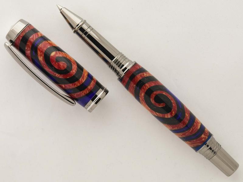

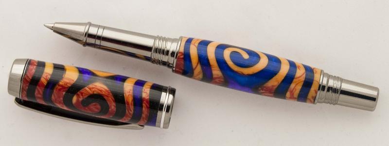

Todd, Thanks so much! I did exactly what you said and it worked like a charm! There looks like a little gap near the fittings..it's actually part of the edge of the darker blue part of the blank. Now, I have one more pen that is bugging me sitting on the shelf that I can do the same with. I really learn from being a part of the IAP.. Todd, Thanks again. ...oops no picture didn't happen so pic attached..
Excellent, Glad it worked for you... It's a nice technique to know, maybe someday I'll need to use it myself...:rolleyes:

Thank you for the kind comments and encouragement. Now, I'm really satisfied with this pen after I took Todd's advice and used the sanding mill to get the blank flush with the fittings. The fit is now where I like it.
