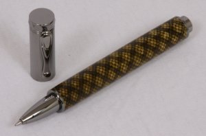

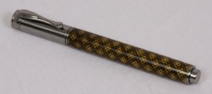

Here's my latest. I actually started it over a year ago and finally got around to finishing it tonight.
I know i'm a little younger that many other members, but when I was in grade school, we would make what we called "friendship bracelets". Don't know if everyone else called them the same or even made them at all. Basically you take embroidery thread and tie knots to make certain patterns.
Anyway, long story short, I made a cylindrical friendship bracelet and stretched it over a tube. I was going to cast it, but decided just to soak it in thin CA and then build medium CA layers on top of that. I think it was probaby easier that way since the thread is fairly thick and I would have turned off most of the acrylic anyway.
I'm proud of this pen because it's one that was truly my own original idea. It takes a while to make the "bracelet" part, but you can make many different patterns and obviously use just about any color you can think of, so you can be creative...
Let me know what you think!

Jeremy...you are right...very original. Looks nice too. What is the bracelet material...is it a thread / string or some other ?

Jeremy, a fine looking pen, umm bracelet, uh whatever. Ok , do over. Are all the points I see in the photo, knots? You must have teh patients of Jobe. No wonder it took a year to make. Great work. Congratulations.

I also see the word knots. Is it possible to see the back side of the pen if that is where the knots are??? Not quite understanding the tecnichue. Looks alot like PC work. Nice job and thanks for showing.
Yes, the material is embroidery thread.
Charles
Yes, each point you see is a knot. I think they are technically half hitch knots.
The pen looks the same all the way around. The dots that you see are the knots. When tying the knots, once a row is created, one end is tied to the other, making a complete circle. It's hard to explain without pictures, but think of a tube sock... not sure exactly how they make socks, but there's no seem on the upper portion. The "bracelet" I made is the same way.
very creative! Outstanding job on the finish..how many coats of ca did you end up using?
Good question, I think it was probably 8 to 10, maybe a few more? I put on a good coating of thin. Then I built it up with medium and accelerator.

Oh, one more thing. I did paint the tube black. There are small holes between the knots and I was afraid you'd be able to see the brass.
