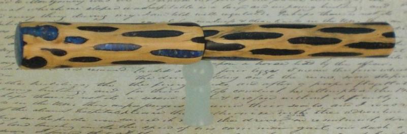

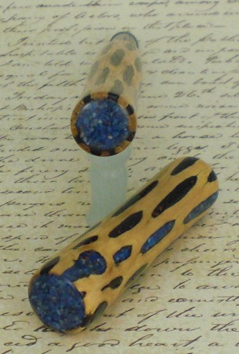

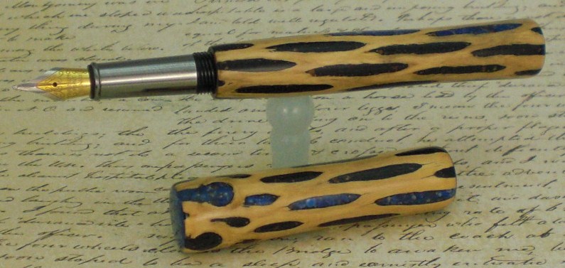

My first double closed end pen. A Cholla Cactus Bl/Tit. FP with Blue Lapis and Coffee Ground Inlay. There are only 5 of the original pen components in the pen (the tubes, the FP nib, the tip coupler, and the cap threads). I had to reinforce the ends of the Cholla with some scrap wood. The pen was turned on a wooden jamb chuck without the use of the tail stock for steadying once the Lapis was added.
I decided to take the contest as a challenge and was certain I could make the pen. I just had no idea how much fun and frustration would be involved. I was trounced by very skillful artists and next year my entry will be better because of the challenge.

Hans,
An amazing pen. I don't think I've ever seen anything like it in choice and combination of materials. I don't consider any of the entrants to be "losers" in any sense of the word. Great work. Thanks for sharing it.

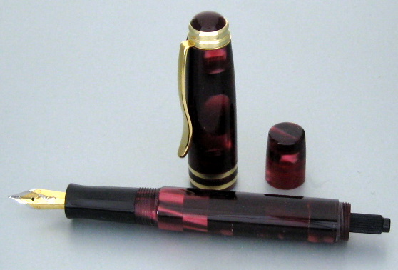

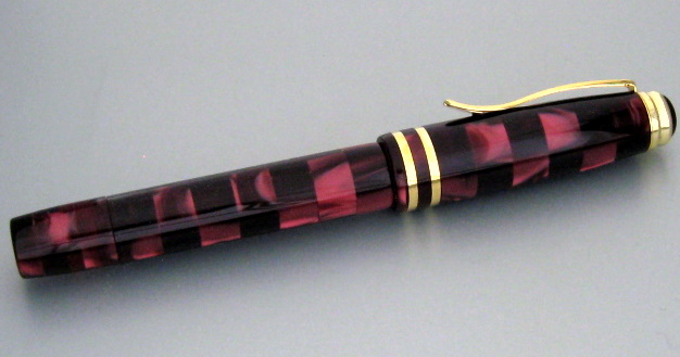

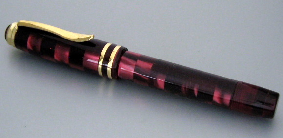

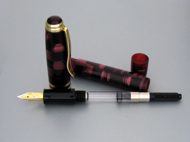

Mine was the Sierra-style fountain pen:
The threads are triple-start 10mm, the primary material is 1930s cellulose acetate, and secondary material is ebonite. The trim ring is brass. I used 2 10K sienna kits for this one, and ideally wanted to enter it in the "Frankenpen" contest, but it wasn't eligible due to being a fountain pen.

Joe, your pen reminds me of the pen in this year's logo. Great work! And as a finalist in the Frankenpen competion.... I am glad fountain pens weren't allowed. :biggrin:

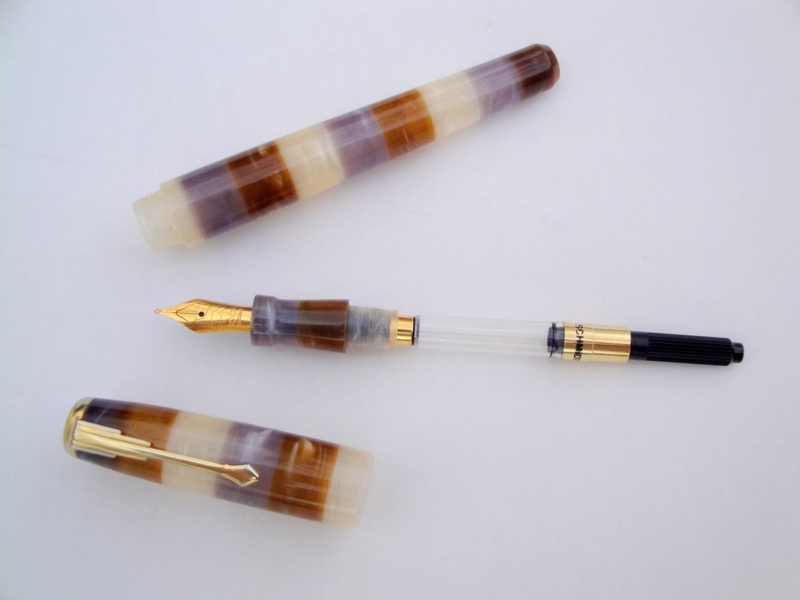

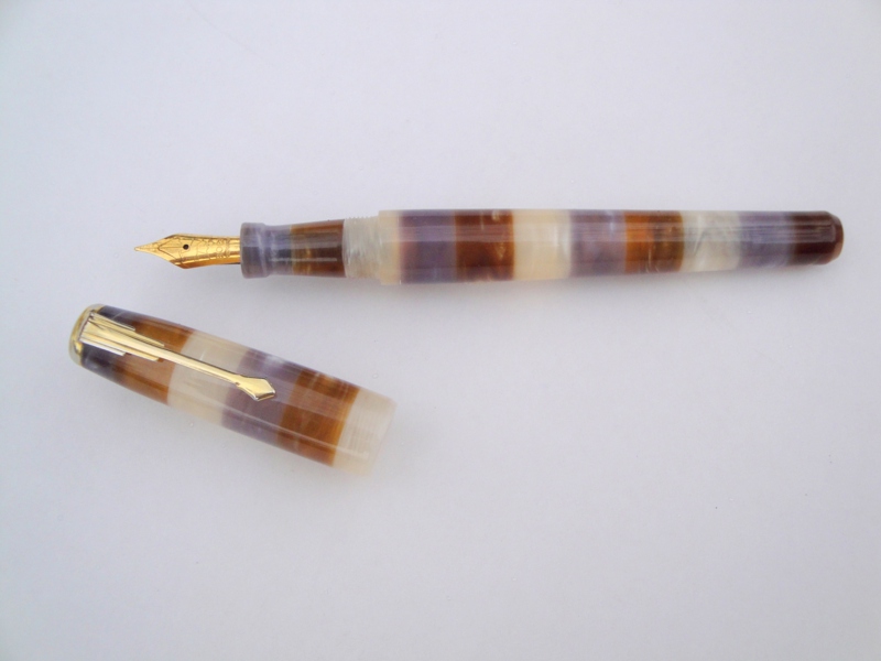

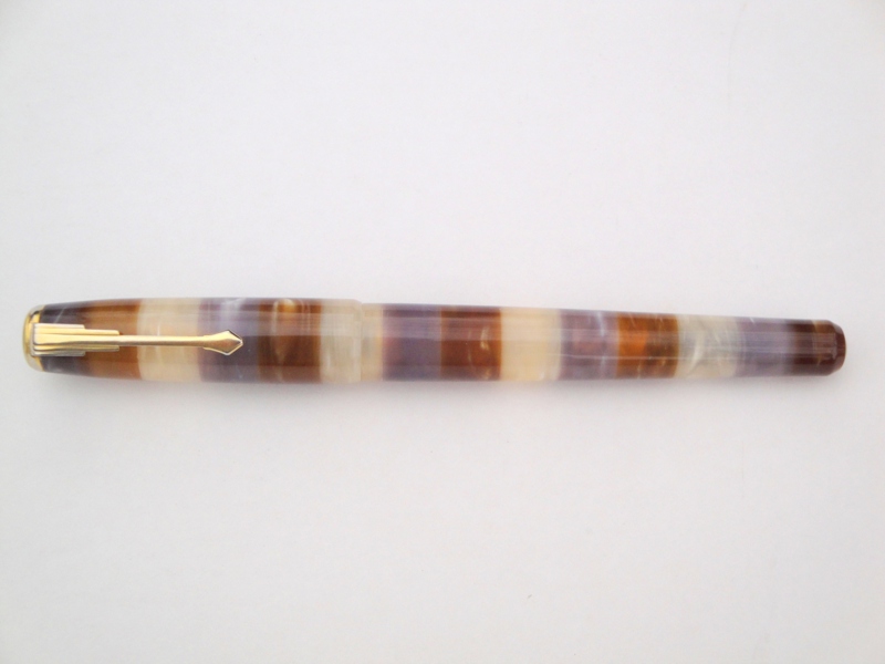

This was my entry into the Freestyle contest. I knew I was outclassed going in, but it was fun to complete.
This was kitless number 3 for me, and it is done in an Italian acrylic. The acrylic is semi translucent and really beautiful in person. My photography does not do the material justice--something I definitely need to work on.
With the design, I tried to focus on maintaining the pattern while masking the dark components. This was a lot of fun to make, and I look forward to doing more in the future.
