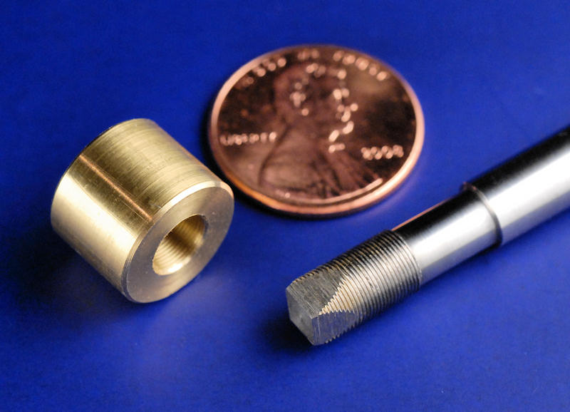

i do have a metal lathe, not very good on it yet tho. is there instructions on here on how i would go about making a tap?
thanks
stevo
Essentially you cut the thread you want, and then file/grind flats to make cutting edges:
While it might look like this style of tap would push material out of the way, it actually does cut very well. The main disadvantage is chip clearing which shouldn't be a problem since none of the holes are blind.
Normally you would grind three (not four) flats and have the thread tapered a bit so it doesn't start cutting all at once.
You can harden the steel if you want, but if you are only cutting plastic it shouldn't be necessary.
