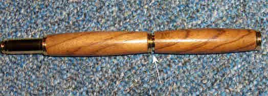

Made my first fountain pen Last Night. I think I did an OK job with the turning and finishing, But the assembly went awry. :(
This is the CSUSA Fountaing Pen, The inexpensive one. I followed the directions explicitly, yet the cap does not fit properly. I know its the liner, but how can I correct/fix this? I want to use this in public, not hide it in the basement with the rest of my "creations" :(

Use a nib cap adjuster tool or a screwdriver to tighten the white plastic piece inside the cap. This will allow the cap to seat at the right length. Just be careful not to strip the plastic piece.
