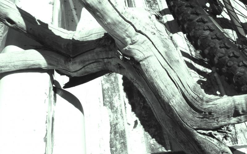

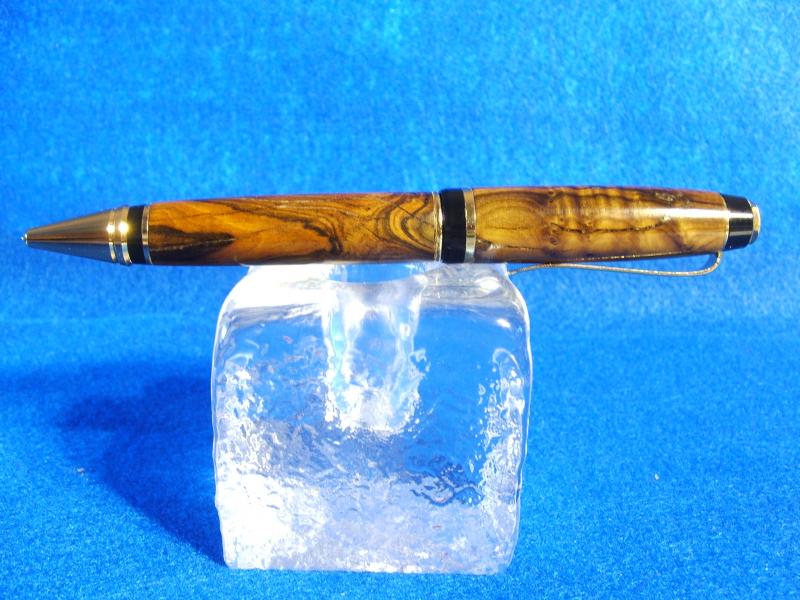

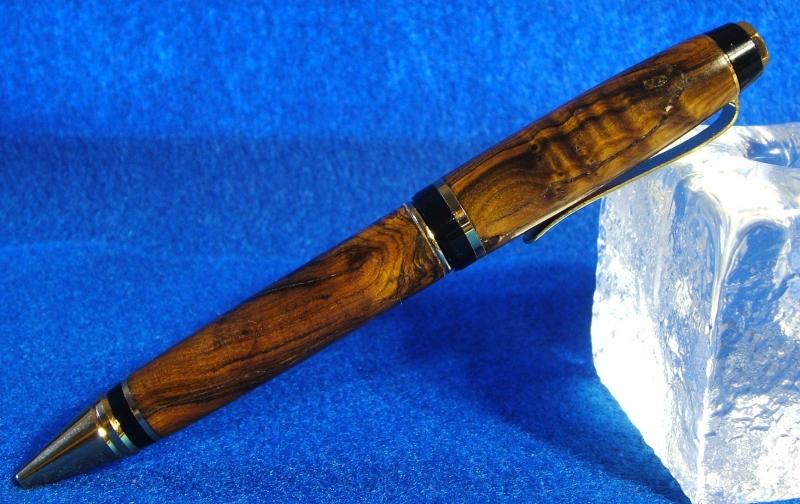

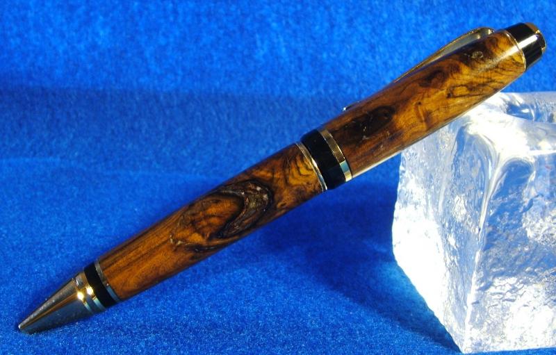

This Wood grows all over the desert as scrub brush, I found this piece on the side of the road after a grader ran over it. It has a lot of cracks that I filled in with CA. The outside is ash gray in color but the inside is something else. Any suggestions on how to fill in the cracks better or how to keep the C.A. from turning white would be appreciated.

Very Nice Rescue! I love to see wood with character. You gave that poor road kill a nice resting place. In someones hands.

It's been my experience that ca will turn white if to much accelerator is applied. I think it has something to do with the heat generated by the chemical reaction. Its amazing what mother nature can give us if we just look. Some of my nicest pens are from wood found laying around the ranch I hunt on. Great find and a great looking pen.

Nice save, pretty wood though The wood looks like Desert Mesquite, when I was a pup we used to live in Las Vegas way back in the 50s, I had to help my dad clear a building site Way Way outa town it was off east Charleston about 2 miles east of Boulder Highway, that stuff was so thick it was insane, but right in the middle of this thicket was a huge old cottonwood tree. we used to call it grease wood from trying to burn it green it was a little oily, sure wish I had some of it now.

Next time you are at Home Depot or Lowes ask the key guy for the shavings from the key machine. Fill the cracks with the shavings and then the CA. When I fill the cracks I tap the side of the wood to get the shavings to settle in. Works well and it is free.

Next time cast alumilite around it under pressure and it will fill in all those cracks....dye the alumilite to get a neat coloring effect. This is known on the IAP as "worthless wood".

CA's really not that great of a filler....it's properties don't allow it to bond to itself very well, only to bond two mating surafaces....the tighter they are pressed together the better CA will bond. If you're looking to turn the wood and then fill the cracks, especially large cracks, then epoxy would work much better for you. Inlace is basically just (expensive) epoxy with powders in it. Cracks can be a neat opportunity to color fill and add even more character to the wood, but if you're just using CA with no coloring and you can see through the crack down to the brass, then that doesn't really look too sharp, IMHO. Overall though, nice save on the wood! I think the wood itself looks awesome for a piece of trash (essentially). You have the essence of what worthless wood is all about....bringing out the beauty in junk wood that others would entirely neglect.:biggrin:

Well I am very close to vegas and I do have Mesquite on my property but this is not mesquite, I think you got it right with the grease wood, from what I can tell this is a Bush like plant that has small yellow flowers on it, and grows every where out here. I am going to start searching for some better pieces since this one came out so nice. If I find some I will keep you in mind. Thanks again Max.
