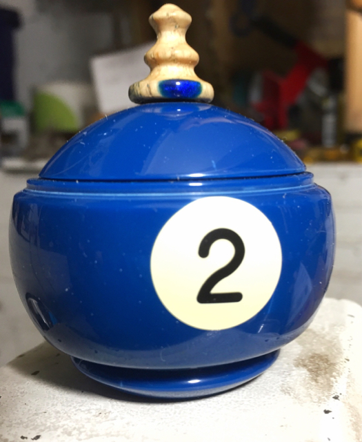

I drill and tap billiard balls for handles on my reloaders. Saw a picture of a lidded box made from one and I figured it would be a good use for some pen blank cut offs.
I know what a pool ball spinning at warp speed sounds like careening about the shop too!
This is the first one of these things I have ever tried. Holding the ball and centering things was a bit of a challenge.
The design changed after it when on a walk-about, had to turn out some chips.
As you can see the knob on top is a pen blank cut off.

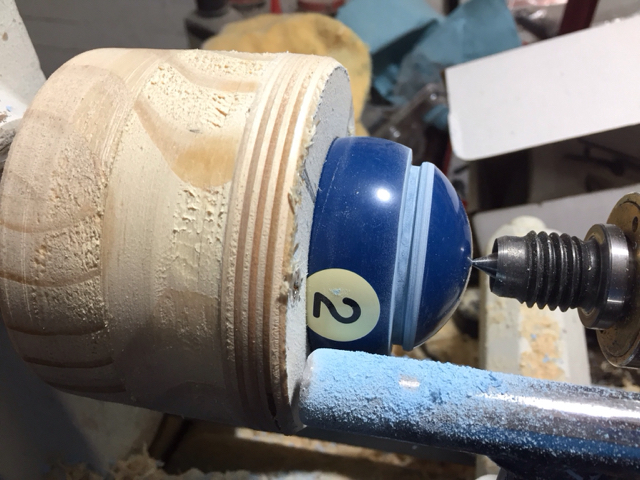

Here is what I ended up with.
2" thick face plate mounted on a 1x8 nylock nut. Nylock part removed. It's recessed and epoxied. The locking nuts are tall enough that they don't bottom out. No,shimming required.
Cap was made from 1/2" ish Baltic birch, screwed to the faceplate for drilling.
I drilled a 2" hole though the assembly to seat the ball.
The Baltic birch was then drilled to 2 1/8" to allow more exposure of the ball.
Drilling this way centers the ball so you drill top dead center providing you drill with the lathe.
This picture shows the ball getting the lid cut. The point of the live center is marking out my 1/4" drill spot after it's separated. The Baltic birch top or cap is still screwed on.
This picture shows the ball held by the cap and some 2" screws. I would recommend highly that shorter ones are not used. Those balls are hard and run around a long time when they get loose.

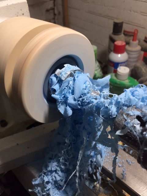

I did the bottom with a scroll chuck reversed into the hole after I finished hollowing it.
The material turns easy if you know how to sharpen tools. You don't cut very much before you need to sharpen.

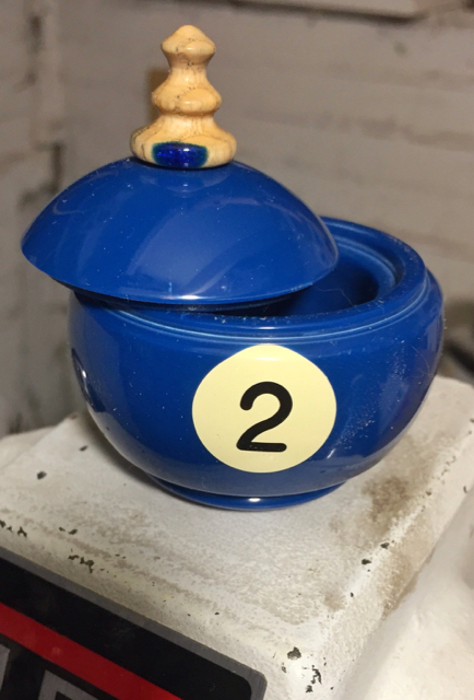

Holding a slippery, perfectly round object is a fun challenge. Once you start you need to figure out how to dismount and remount the round ball in the same place. I found that to be very challenging.
The numbers are right side up and upside down on the balls I have. I'm not a pool player so that might be normal. When using them as a reference it can throw you. It's round, both sides look the same but ones upside down. Mark one with a sharpie.
I cut my lid with no thought on how to finish it. In hindsight I should have planned that out first.

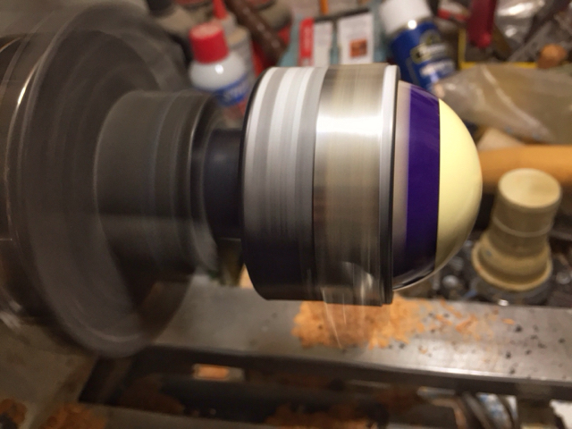

Here it is. It's a combined idea from both jttheclockman and Mr Vic.
Here is a list of what I wanted for this ball gripper chuck thing.
I needed it to grip the ball to prevent more dents in my helmet.
I needed to be able to easily adjust the ball to get the stripes parallel.
The end of the ball has to protrude far enough to part it off and form the lip.
It needs to automatically center the ball for drilling top dead center on the lathe.
I wanted something I could easily take off the lathe and remount.
I wanted it to be easy for anyone to make using common materials from the hardware store.
For about $5 and twenty minutes time here is the "JT VIC Ball Gripper" in action!
