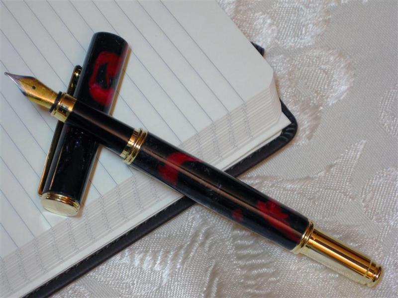

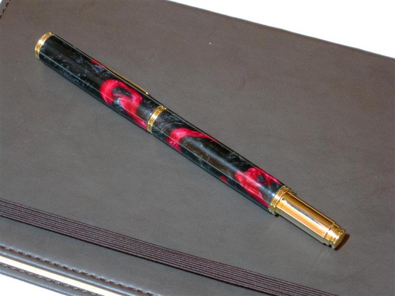

Here is your cast Chris. I had no idea what was inside and was pleasantly surprised by what it had in store.
Beautiful red swirls hiding among all the black and grey :eek: :biggrin:

Working on some better pictures now.
It's the Artisan FP kit from CSUSA. I don't recommend it as I'm not very happy with the way the snap on cap works and the fact that there is no trim ring of any sorts for the bottom of the cap barrel, so when you take it off, it's an exposed blank end and tube.

That turned out nice. Now I am gonna have to make a few more like that one. But you made it look nicer by putting it on that fountain kit.
