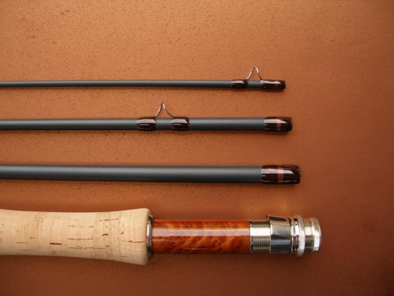

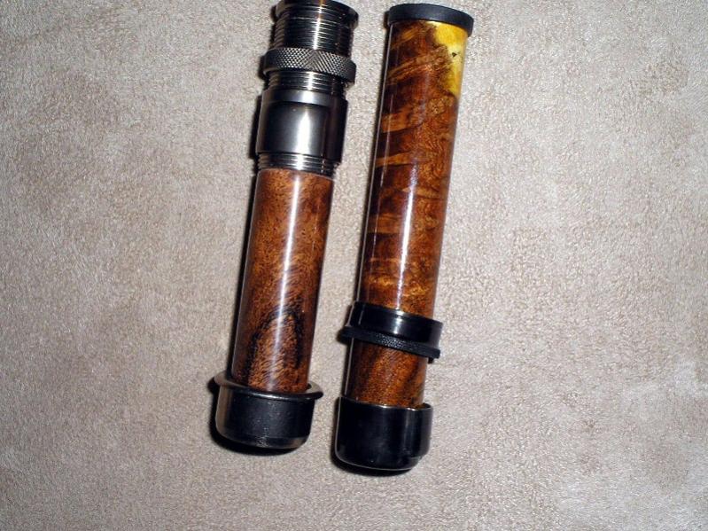

I've been building fly rods for many years, but for the last year or so I've added my own lathe work, the wood insert in the reel seat. The turning part hasn't been difficult, but I've spend a lot of time working with Cyanoacrylate, Spar Urethane and Moisture Cure Urethane finishes. The wood is turned past target diameter, then successive coats of finish are built up to beyond target diameter. Wet sanding with 400/800/1000/1500/2000 grit sandpaper is followed with 8000 and 12000 micromesh. The final steps are two grades of car polish.
The wood on this rod is redwood lace burl.

Nice work Jeff!
Love the trim bands.
What do you use on your wrappings? It looks like hi-build, but I guess it could be a couple of coats of thin....
Cheers!
Gary

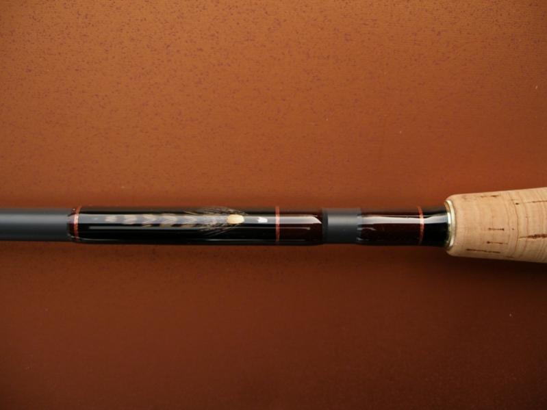

Thank you for the kind words. For this particular rod I used high build, but the applications are spread on very thin. Usually three light coats are applied. It's hard to say how many hours go into a rod, as there are independent stages like gluing the cork rings and turning the grip. Then there's the reel seat insert which takes a week of applications and required drying time before sanding and polishing the finish coats. Adding a feather inlay also adds time.
Overall, the assembly and guide wrapping isn't difficult to learn, but like pen turning and finishing requires an attention to detail. "Fit and Finish" run through my mind during the process.

Of course you'll turn your own reel seat insert for your first rod. Obviously, the wood turning will be no problem since you already turn pens. A slight difference will be the finishing techinque, where you will be creating a finish that will build/polish to the tolerance of the reel seat hardware you select.

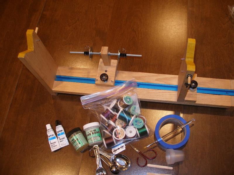

Don't get too wrapped up in tools. I've been doing this for quite awhile, and other than building a simple dryer recently, this is most of what I use. Home made wrapping stand, not pictured is thread epoxy.
Jeff

Jeff, I spent just a little time in the shop today and made the wrapping stand. My wifes micro wave oven recently stopped heating food so I have a source for a low rpm motor. I hope to add that today.
I think I am going to go get some cheap sewing thread today and just practice doing wraps on a piece of dowel. never know I may come up with something worth showing off.
