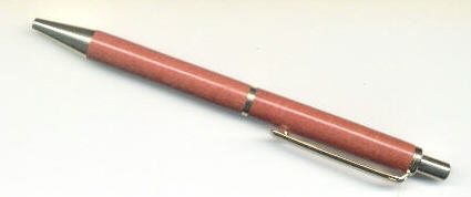

I don't know if this would be an option, but my personal preference is a click pen from WoodCraft.
<br />
If you make your own center band you can make this pen a bit fatter in the middle giveing it a nice feel.
I realize the picture makes it look like a slim line, but it is actually a bit thicker. The only thing with this kit is you have to be sure not to trim too much of the brass tube when squareing it up, or the click mechanism won't work properly.

So far I have had good luck on the click pen in the picture. The clip is not very strong though.
I have not heard of anybody doing the Flat Top American click pen though. I would interested in how well it works. Most people here don't like the click pens in general from past bad experance or just prefrence. You might have to try a couple and let us know!
