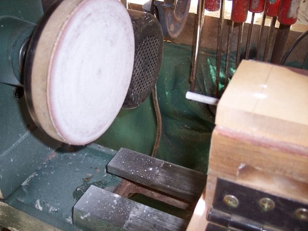

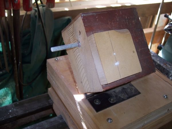

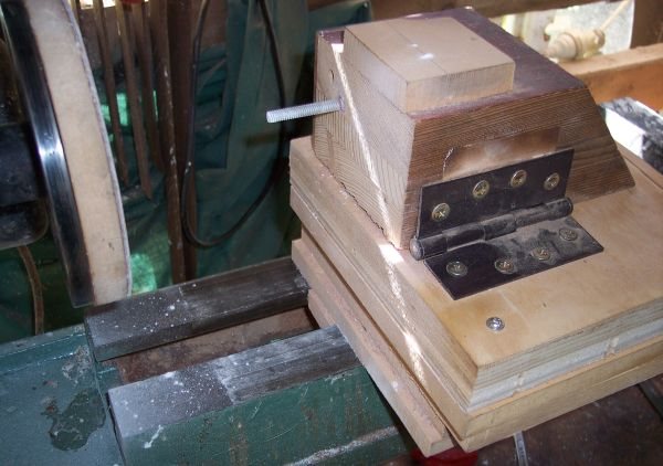

Hi,
From time to time there has been posts about pen mills,so thought I would show you mine.
It is a jig I made to slide in the lath bed upto a faceplate sander.The 1/4 in bolt in the jig is drilled by the headstock so it is square to the face plate. The top half of the jig is hinged to the base plate so that it can be moved accross the face plate sander.Turned blanks are used on the bolt to accommodate different pens the same as with a pen mill.
I have been using this system for 10 months and find it easier,quicker and very accurate.I never use a pen mill these days.
Not my idea,passed on to me by a friend,but I love it.
Regards
terry
