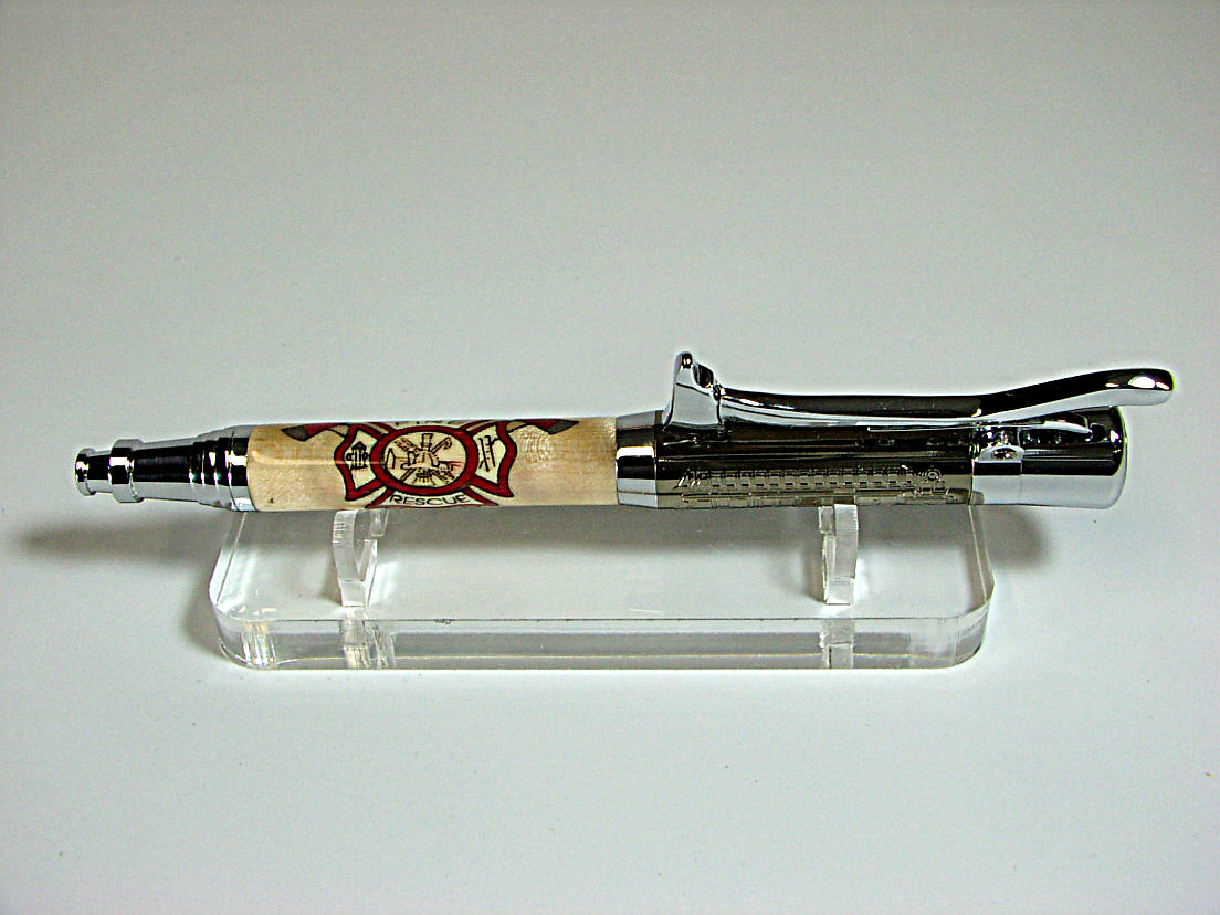

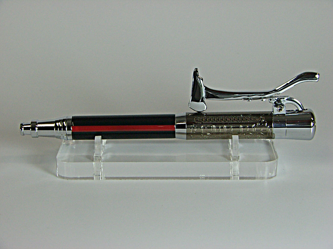

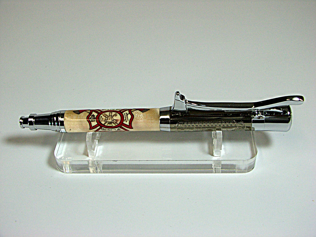

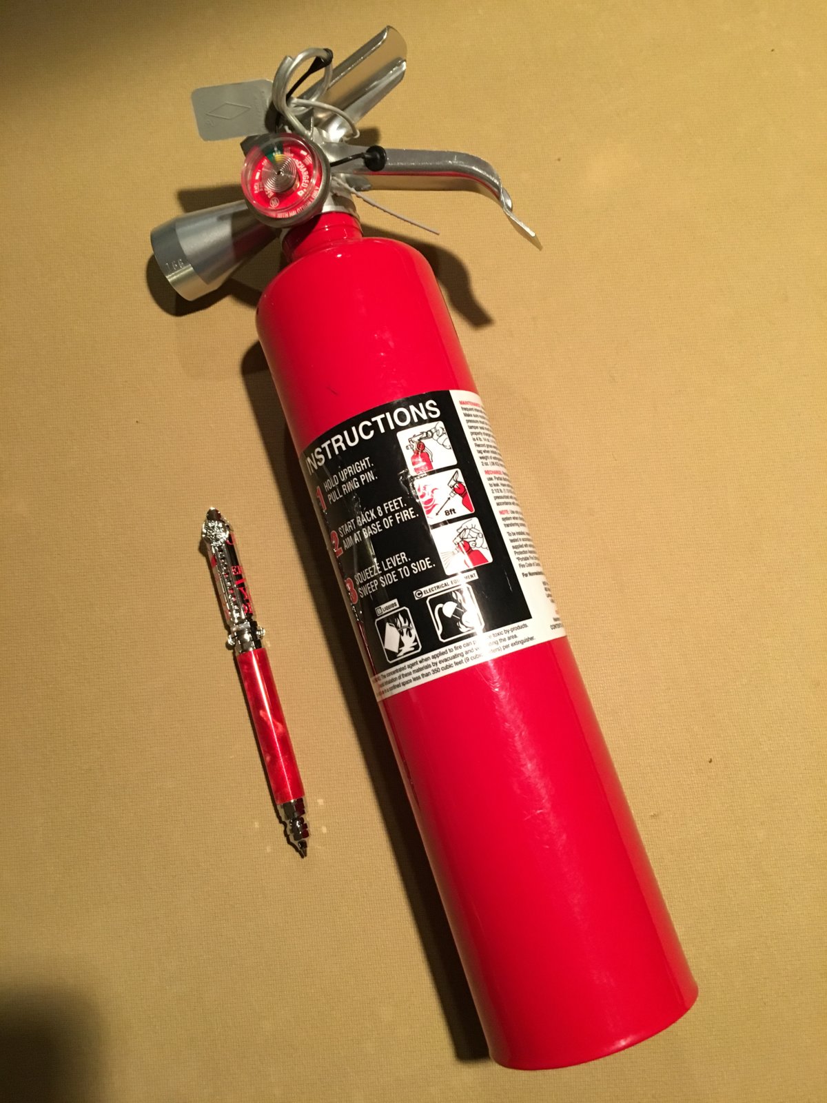

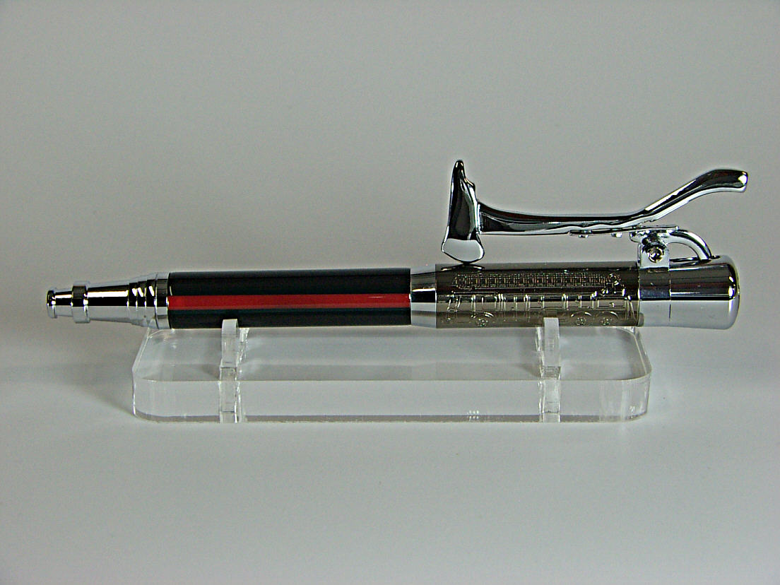

Being a firefighter there are some real cool themed pens that firefighters love to get as gifts or give as gifts. Here is a couple I did.
The thin red line theme and also the maltese cross inlay on a firefighters kit.

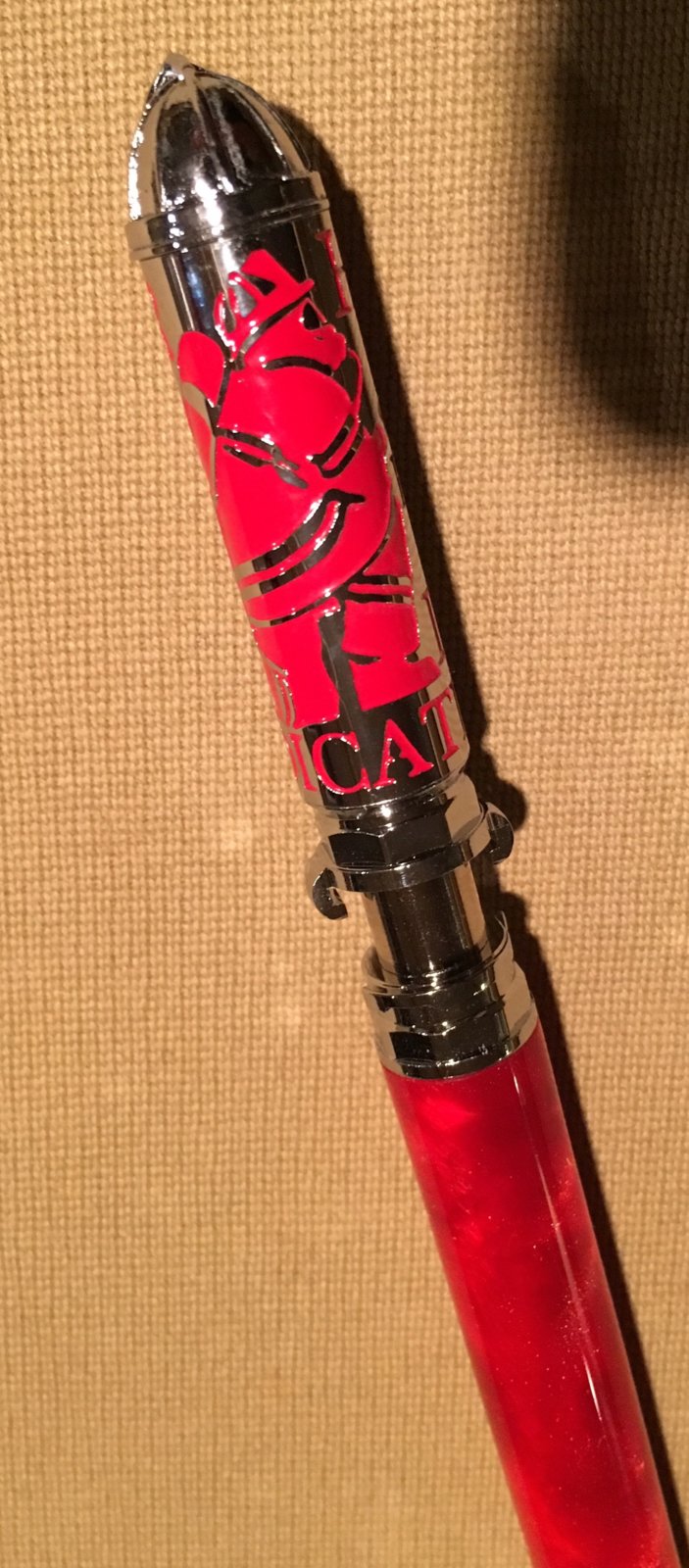

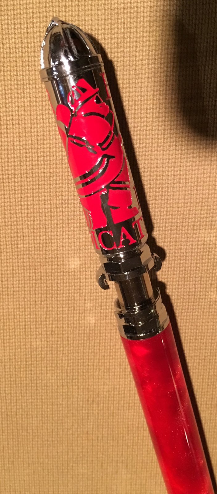

HiJack continues. FF pen.
