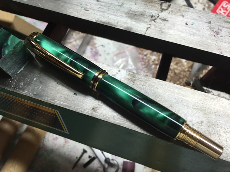

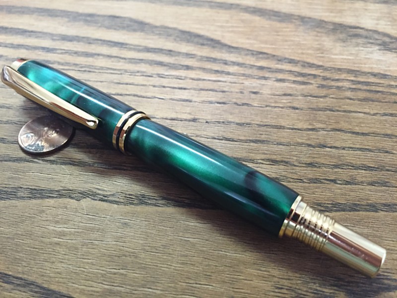

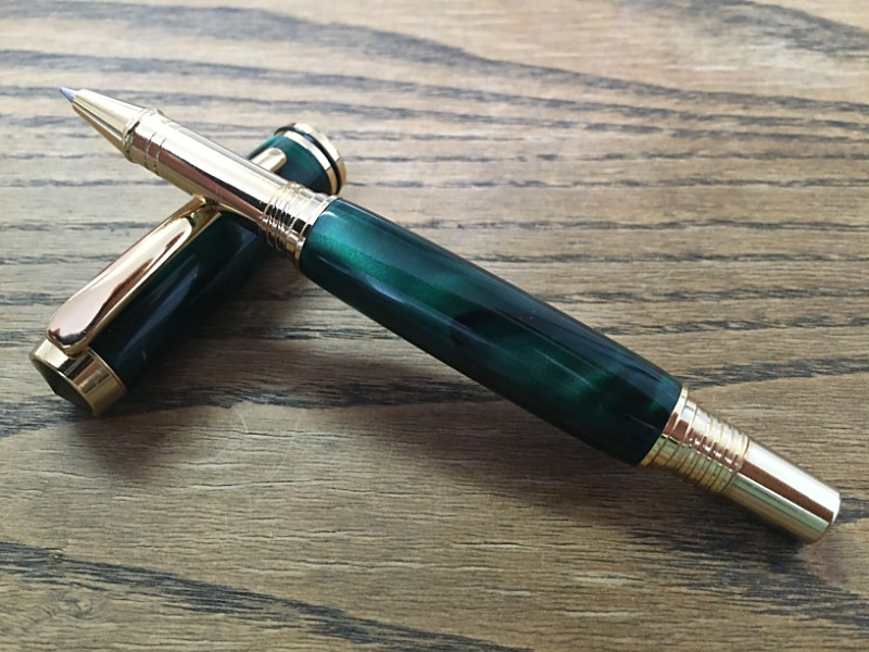

This is my first project using acrylic and my first pen that isn't a slimline or bolt action. 10k Jr Gent II. Please critique me. Obviously, photography isn't my strong suit.

Back end looks wider than the front end. Did you reverse the rings? If so it's a nice profile and blank. The pen looks good from here. Nice job.
Jun 2, 2015
81
Modesto, CA
Thank you very much. I thought it looked funny.
Let me tell you a story. I made the cap and completed it before starting on the barrel. I am turning between centers and thought this would be the way to go. Next, I mounted up the barrel blank and and trued it up. I realized that the nib and end cap couplers were different diameters but I assumed that the nib was the smaller diameter. after truing the blank up I looked at the pen parts and realized that the nib end was actually the larger diameter. This seemed counter intuitive to me for some reason, but I switched the bushings and went on my merry way. I completed the pen and pressed everything together, but I forgot to put the cap on to orient the barrel blank before pressing so the "grain" didn't line up. But, at the time, the barrel was facing the correct direction. I took apart the barrel and punched out the nib coupler end and oriented it correctly and put everything back together. Now the "grain" of the blank looks fine, but as you point out, the barrel is backwards. I inadvertently switched the nib and the end cap when orienting the blank. Now I have to take it apart again. Why are these interchangeable!? Hehe. Live and learn!
TL:DR I switched the end cap and nib on the barrel.
