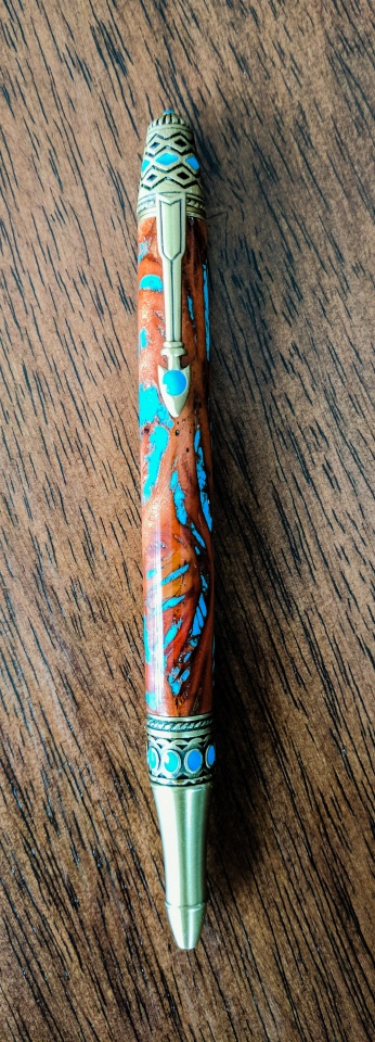

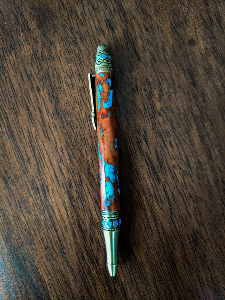

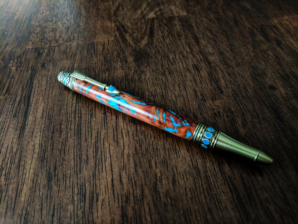

I decided to make a turquoise inlay pen as a birthday present for my mom. She makes stone jewelry for one of her friends (who has sold jewelry at craft shows for many years). She likes the stones, so I figured turquoise would be the ticket. When I first started with pens I made her a slimline that is actually kinda crumby by my current standards, but she always talks about different people that comment about how nice it is. She likes the size of the slimline, so when I came across the Southwest Mesa I knew it was just right. The wood is rose gum burl that I knew had a bit of internal cracking and checking. I turned down to about 0.015 proud and then filled with crushed turquoise and soaked in thin CA. If I was to do it again I would use a Dremel to clean out the cracks to make them easier to fill and more uniform. Also the epoxy that I used to glue the tube ended up filling some of the voids and showing the tube, but lucky the kit is brass colored so it doesn't look too bad. Even with the rookie mistakes, I like the result. All C&C welcome.

I love that effect and I'm going to try it. Do you not think that using a Dremel might just soften the lines of the edges too much and perhaps make the effect less natural looking? Worth try maybe. In any case your mom will just love her pen I'm sure.

Absolutely beautiful! :)
I have made a few pens with tourquoise inlays, but this is much better - well done! The effort is well deserved.
Thank you for sharing.
Sent from my Nexus 6P using Tapatalk
Since I was still a little larger than the finished diameter when filling, some of the gaps were covered by wood and ended up being filled with just CA. So when I turned it down the holes have the appearance of CA filled gaps. I think combining some Dremel work and a sharp knife would've resulted in crisper lines. here is a link that I used to get me off the ground: Inlay Turnings. It is really much easier that you would guess, just kinda tedious. I highly recommend giving it a try

Wow !! . You did a fantastic job !!!!
You said:
"The wood is rose gum burl that I knew had a bit of internal cracking and checking."
It looks to me that it was nearly 50% cracks/voids.
You did wonderfully well to fill them in so attractively !!!!
Oh I see, not obvious in the photo. Thanks for the link [emoji106]
