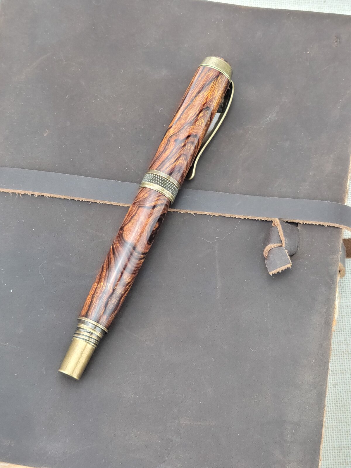

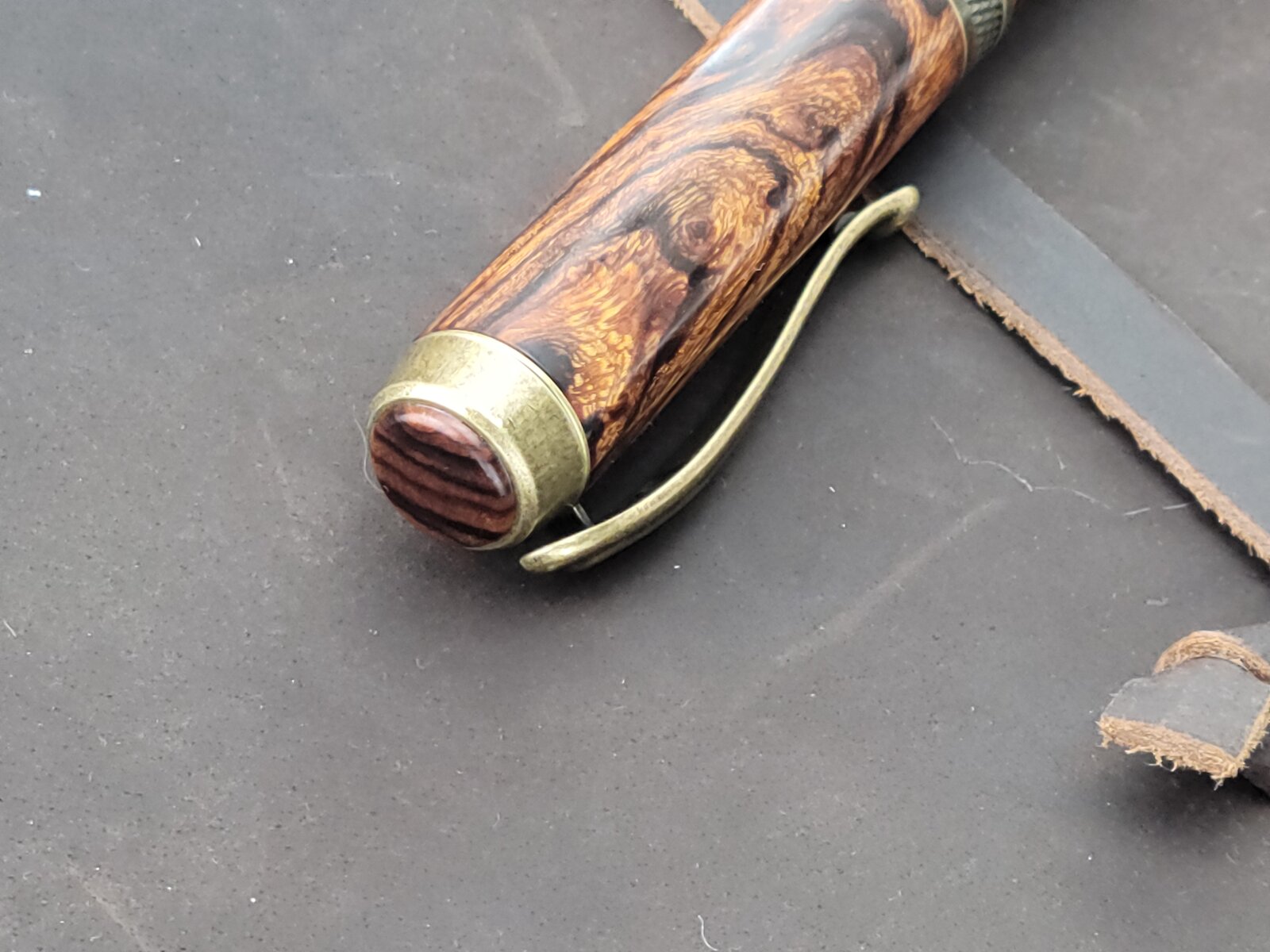

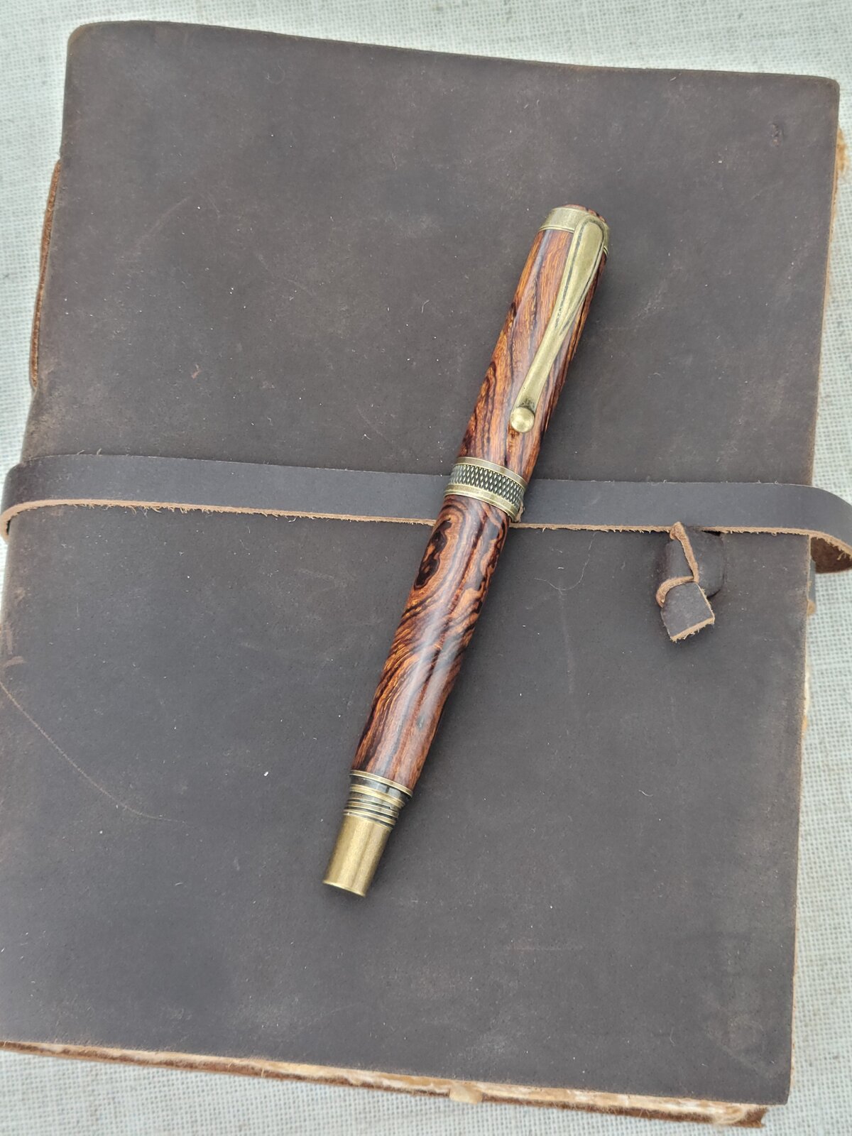

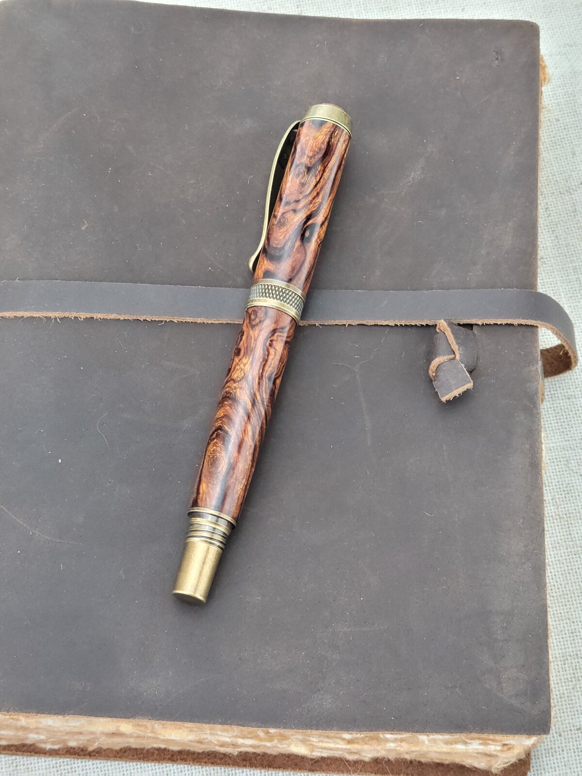

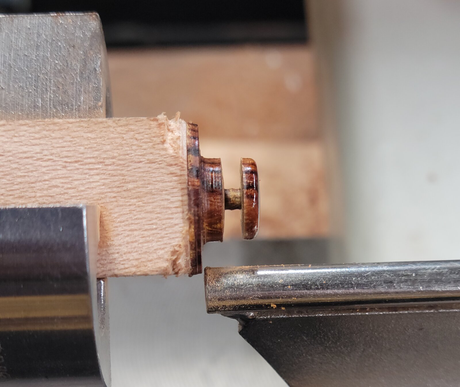

So, I finally turned some DIW. This is a blank that I bought from @Ironwood Bill. I like it. It turns nicely, though it's definitely hard and dense. I did have a very slight chip-out. It was more like a little scratch that I filled with CA. The clip covered it pretty easily. Other than the finial, I kept it pretty simple. This blank didn't need any help looking good. This is a Diamond Knurl rollerball kit in antique brass. I sanded to 600, used the 3 lower grit zona papers (dry) to shine it up, then finished with pen's plus. For anyone interested, there is a pic showing the final part (pun not intended) of how I make the finials. I leave about that much "stem" on it, then cut it with a utility knife.

I do my finials the same way. Bonus tip: you can also use that stem to polish the buttonā€¦
