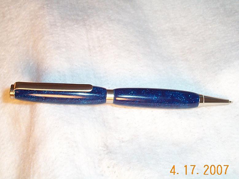

Here is my very first one,this is just the beginning of stuff i am going to start dumping into the mold.
I will have to find it cheaper though.
