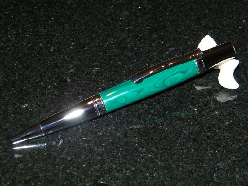

I've always enjoyed the look of trustone, and finally had an opportunity to give it a shot.
The banded malachite turned really nicely - very much like an acrylic. Though it did try to blunt my tools a little more that acrylic does.

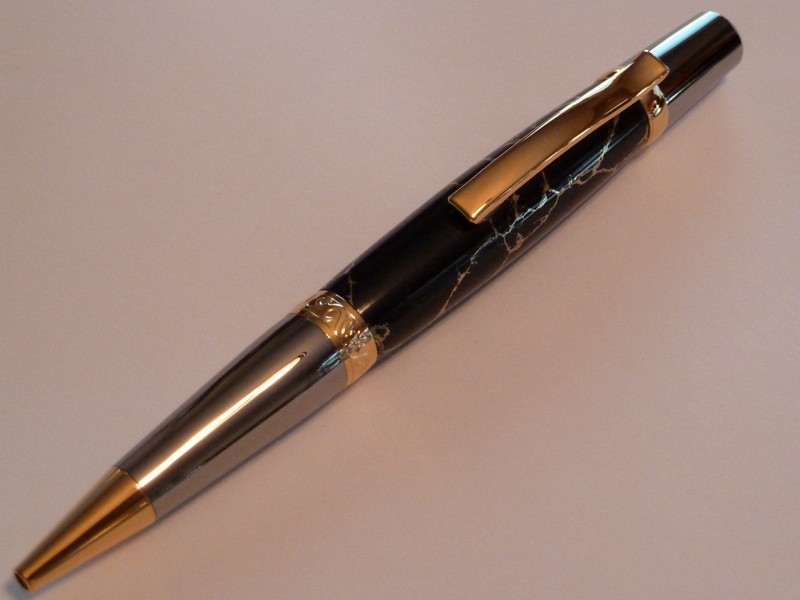

The black/gold matric was like nothing I had turned before. wow, that stuff is hard. Both the roughing gouge and the skew went through multiple sharpenings during the turning. And it wasn't shavings that came off of it - it was more like dust!
Based on advice from Butch and James (thanks guys) in my earlier post asking for tips, I took as light of cuts as I could and gave the blank plenty of cool-down time while working with it - usually during the times I was going back to sharpen the tools.
Finished it off with the 3-stage buff system. But rather than the harder carnuba stick with the system, I opted to try a paste-based wax used for granite. I put on 8 applications of that. Each time I spun it on the lathe until it dried, then while it was spinning on the lathe used the buffing wheel on a cordless drill to buff. The shine not showing so much in the photos is more a testiment to my photography than the turning. I was very happy with the shine. Though I am curious to see from the friend that ordered the pens if/how well the finish lasts.
