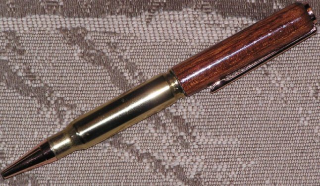

Here's my first bullet pen worthy of showing in public. Not up to my standards for selling, but I learned a lot so hopefully the next one turns out better. This pen uses the arrow shaft that was posted some time ago.

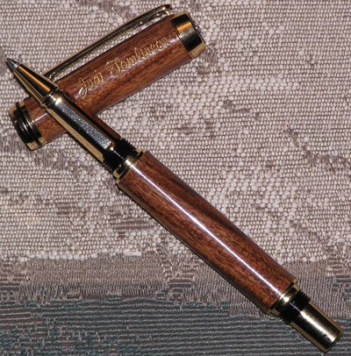

And this is a custom order Baron done in Koa wood. It appears I sent it off to be laser engraved a bit early, as the packing bubbles totally destroyed the lacquer finish. It was engraved and sent back to me. I disassembled it, threw it on the lathe, gently sanded off the existing lacquer finish, then started the finishing process all over again. Only thing I haven't done to this pen is apply anything after finishing with the MM. I didn't want any wax or polish settling in the engraved areas. I've come up with a new jig after this one to help keep the casing from spinning when drilling it. Hopefully the new jig will keep the casing from being crushed as well, and I'll watch the heat more closely next time so the brass doesn't discolor when drilling.
Thanks for looking and all comments positive or negative are welcome.

The cap has the same lacquer finish as the body of the pen, just doesn't show in the photo (still working on my photos, can you tell? [:I]). I sprayed the lacquer right over the engraving, the engraver said it would be fine.
