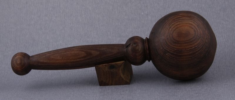

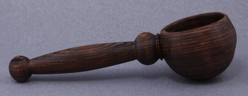

Ok, this is only the 3rd non-pen item I have turned and it was planned as a "rough draft" to learn from so I used redwood because it is soft and easy to turn and finished it with several baths of mineral oil (I actually thought it would be a throw-away when I was done with it but my wife wants to keep it).
Things I learned:
1) Making a jamb chuck is a lot harder than it seems.
2) A good jamb chuck is a must for this type of item.
3) Redwood doesn't work well in a jamb chuck because it is so soft it dents.
4) Redwood is so soft that it dents/cracks as the item flies out of the early/bad jamb chucks.
5) Mineral oil sucks as a finish.
6) I need to work (a lot) on turning round beads/balls.
Any thoughts for improvement would be appreciated!!
GK

Your beads on the handle don't look too bad.
The slight out of round scoop portion of this project adds character and is appealing. Atleast now you can say you scooped up a crooked cup of coffee :D
Overall, I like it!

I just tried the exact same project and had the same problem with my jamb chuck! I made a few screwups and will have to try again. I cut a few maple blanks so I can try again as soon as I find some time.
Yours turned out much better than mine. This was my first experiment with multi-axis turning.

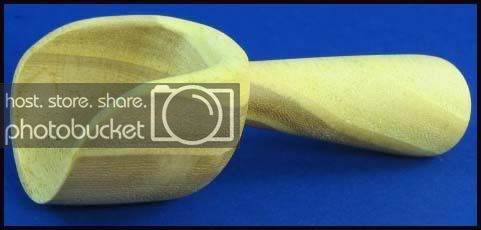

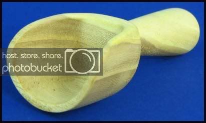

greg, sorry it took eons, but i finally got around to taking a few pics of a scoop i made a while back. this is what i meant by the 'raffan-style' scoop.
by the way, i have no idea what kind of wood this is, if anyone has a stab, i'd love to hear it.

I just finished reading the Raffan book Turning Wood, his version of a scoop looks quite a bit easier than yours does, that has to be scary [:eek:)][:eek:)][:eek:)]

Looks a lot like Pomello. very nicely executed!
