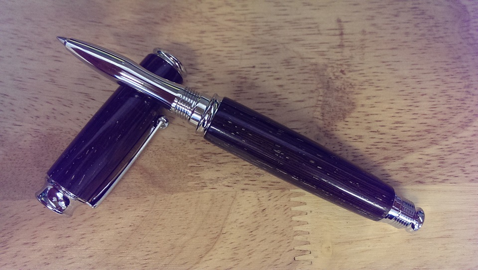

I have been lurking for a month or so while I accumulated the tools to become a Pen Turner... and today it all came together. I have my cheapie lathe, a cheapie band saw (I should stop saying cheapie, everything I bought is kind of cheapie, I'm working on a budget for now), chisels, blanks, kits... everything to start turning pens.
I decided to start with a Navigator Rollerball kit in Wenge. I drilled and turned it (thinking I did a pretty good job turning it for my first time ever on a lathe) and finished it in CA, and then redid the finish, and redid the finish, etc. until I have what you see here :frown:. As you can see there light indentations in the finish which I was never able to get beyond. I would sand it down and re-apply the CA but every time, it came out the same.
I called it a day after several hours and assembled the pen. Of course I pressed it all together without the thread insert that attaches the cap to the body of the pen. Ah well... Mark this one up to practice and onwards and upwards.
Does anyone have a hint on how to avoid the finish problem? I really liked using the CA other than that.

For your first pen it is a great job Eric. You picked a tough wood to do your first CA finish on. Wenge has a heavy grain like oak does it takes a lit of fill to get it smooth. Keep turning and learn a little more each time.

Mike hit it on the head.
Make a few with maple (curly or burl if you want pretty), walnut or "non-oily" exotics.
Deep grain like wenge, palm, bog woods---wait until you've made a few dozen pens.
GREAT job ---but make the next ones easier on yourself!!

You really picked a beautiful, but tricky wood and congrats on getting it all done and assembled! The first time I did an open grain wood, I had a similar appearance. It turned out to be fine sanding dust in the open grain. Although I could fill the grain, I couldn't get rid of the light color in the grain. I solved that by re sanding and wiping thoroughly with IPA before putting the finish back on.
You could try turning a blank undrilled cylinder out of the sample wood. Sand just like you did for the pen, then wipe half of it with IPA and leave the other half alone. Lastly apply your finish and compare the two sections side by side. If you turn it oversize, you can easily re-turn it for another pen.

Eric, the turning looks good. Personally, I would keep working on this one. You are on a budget and you have an investment in the kit. Wood and tubes, not so much. Tap it apart, put it back on you lathe and sand the spots off using maybe a 240 grit. As you get down to fresh wood, get some fresh 240 paper and running the lathe about 400-700 build up some wenge dust on your paper. Add a drop of medium CA to the dust and sand it into the open grain as a filler. Then work your way back to 600 - clean the blank thoroughly with compressed air if you have it, and toothbrush. If you have DNA (denatured alcohol), wipe it down with that and if you don't see any white spots, begin reapplying your CA.
If the previous white spots are too deep to easily remove, you can turn the wood off the tubes, drill a new piece and start over. That pen will look good when you get it right. Don't worry about reducing the diameter of your wood, you can build CA to about any thickness you need to match your hardware.

For an open grain like that Ill turn then use compressed air to blow out the dust from any crevasses. then I fill those holes with thick CA while not on the lathe. Just put dabs in each hole till they fill up. after that dries i can then sand and those pits dont fill with sanding dust anymore

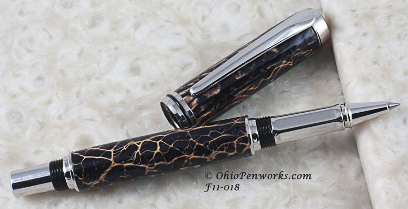

Here's my question: are you sure that pen is a Navigator? I does not look like the Navigator I am familiar with. The attached picture is of the Navigator as I know it.
edit in: I should have read Johns post before asking.:)

Thanks for all the great info everyone! John and MBroberg are correct, I gave the wrong name on the kit. It's a Metro. I've had Navigators on the brain lately, but don't have one of them yet. I am going to try to take the metro apart and redo the barrels, but today I need a success so I am going to try something different.

Is that pock marks/pits/unfilled air bubbles(?) on the lower blank that I see in the photo?
