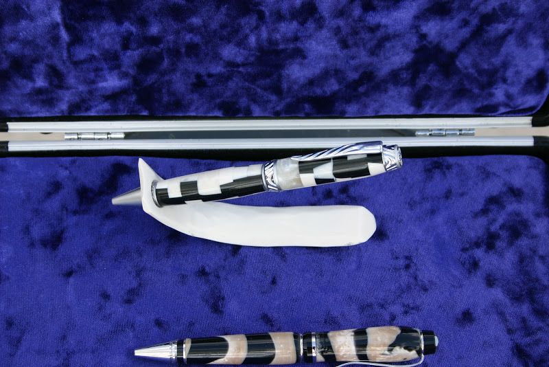

I have been lurking and learning since January. Amazing talent here! I thought it was only appropriate to include a pic. Still working on the photo skills but the tutorials are great. Many thanks to all for the information and inspiration.
Segmented black, white and pearl on satin chrome ultra cigar. The stand was cast / carved from the pen blank.

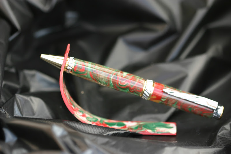

Second pic
Thought I would through in another...
I cast the blank and made the stand from a strip of the blank. Ulrta cigar with gold chrome upgrade.

Those are some nice looking pens, and I also like the stands. Welcome, and thanks for sharing.
seamus7227
Mar 18, 2009
6,220
Wichita Falls, TX
You are learning well, shown by your work! I think the second pic would look really good if the pen didnt lay down so far, otherwise, like the concept! Nice job.
Seamus Rooney
Dec 21, 2008
349
New York
Yes, stop lurking and show us what you can do...........geeeze!!!!!!!! What would it take....to make that stand go the other way..with the hole at more towards the bottom so that the pen stood upright? Duh...remember I don't know much but love to comment.hahahhahaa
David Keller
Nov 30, 2009
1,618
Enid,OK
Thanks for posting these. While the pens are nice, I really like the idea of matching custom stands. I'd love to know how you make the stands if there's more to it than just drilling a hole and heating the material.

Thanks for the kind words. When I cast the resin I make the block a little thicker so that I can cut a strip for the stand. I drill the hole, shape, sand and polish. The pr becomes flexible at around 150 so you can shape to any angle you like.

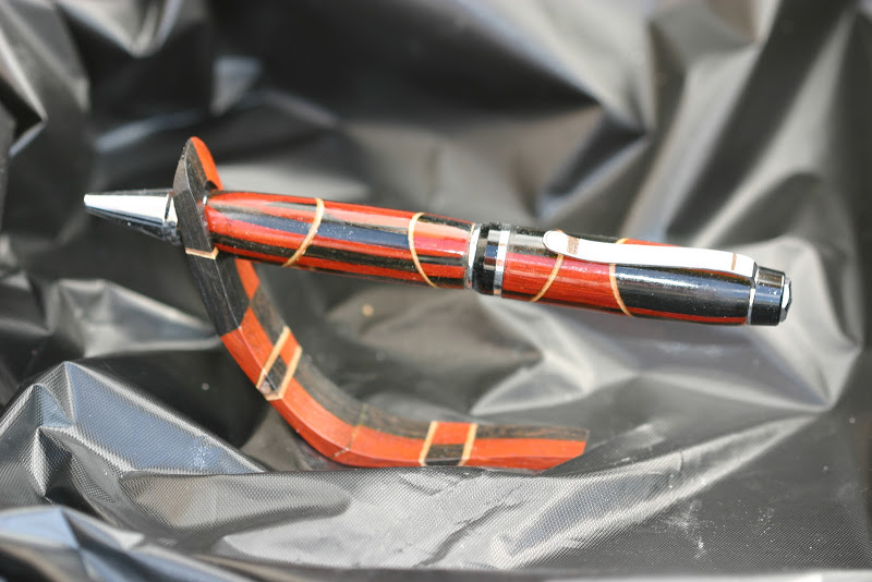

Here is a stand I made of wood using a similar process. To get the curve I cut angles and rotated 180 before bonding. The pen is segmented padauk, ebony, and ash for the thin sections.
You can change the angle at any time by reheating the resin. You may have to sand the bottom flat to correct the balance.
