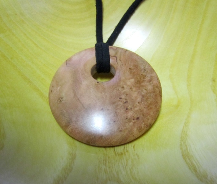

Had only a short amount of time to head into the shop today and made something I haven't made yet, but have been wanting to try doing. Made my first pendant. Used a block of wood on my bottle stopper mandrel to hold it, with some double sided tape to secure it. After turning it, I re-secured it offset to drill the hole and then turn a little bit around the hole.
Wood is Cherry Burl. Sanded to 400grit, rubbed out with 0000 steel wool, buffed with carnauba wax. String is some sort of lacing my wife had in her craft stuff and we're planning to pick up some better lacing this week when we're in town - I plan to make more of these soon. I'll work on getting better pictures when I make some more, hopefully in the next few days. Am thinking I might have to start saving up for a Joyner Off-Center Jig from Ruth Niles...

Matthew, Great job on your first Pendant! Looks like you have done many!
You will like the Joyner Jig from Ruth. (USA made too!)
Thank you! I'm just surprised that I made it through my first one without it flying off the lathe! :eek: After the carpet tape started sliding around, I switched to some heady duty double sided tape that takes some coercion to get loose!
