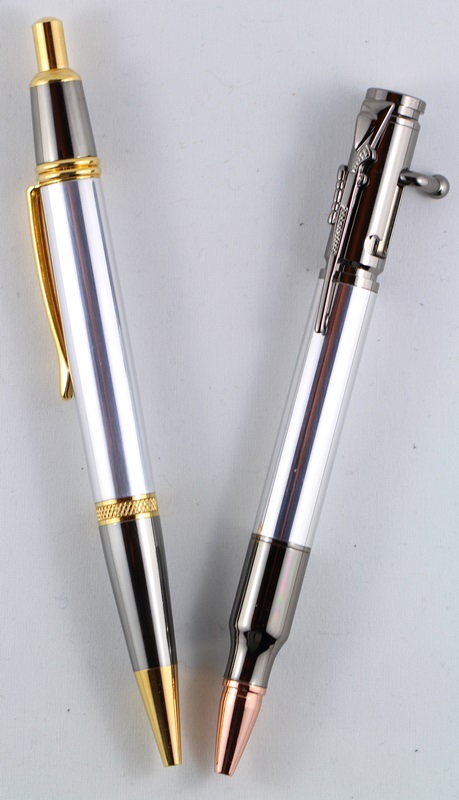

This is something I have been meaning to do for some time.
I bought some 1/2" diameter aluminum rod from Home Depot and made a couple of pen barrels. . It was a whole lot easier than I expected it to be and I am quite happy with the results. . I think I'll give the Bolt Action to my next-door neighbor.
The Bolt Action (gun metal) on the right has perfectly straight sides.
The Button Click Sierra (Ti-Gld and Blk-Ti) on the left is bulged slightly.
I didn't use the brass tubes from the kits. . Drilled the aluminum with a size W bit for the Sierra and with a size S bit for the Bolt Action. . Fit was near
perfect; then glued the parts in with epoxy.
I used my metal lathe to turn the blanks but there is no reason to not use a wood lathe if you do it carefully and take small cuts. . Sanded to 2000 with the same paper I use for acrylic. . Polished with some white paste I had lying around.

Thanks for posting these Mal.
I am still fighting the urge for a small metal lathe, so seeing these and hearing encouragement to replicate with a lathe with wood turning tools is wonderful.
Awesome pens!

Those did come out well.
There is no problem turning on a wood lathe at all. Turn with wood tools too if you prefer but will need sharpening more. Nice to use carbide for at least the initial turning and then maybe switch to a skew. The one warning is the metal fillings and getting them in the controller or motor. They usually are not hot enough for use with a dust collector but I do not run it when turning metals of any kind.

Those look nice Mal. What white paste did you have lying around?
Thanks, Chuck.
The paste is some I got with a starter package of Mokume metal pen blanks I bought from ExoticBlanks. . There were 5 different blanks plus the paste (two tiny tubs, actually, Part A and Part B) and a UV flashlight. EB still sells that starter kit.
