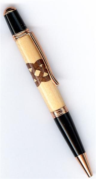

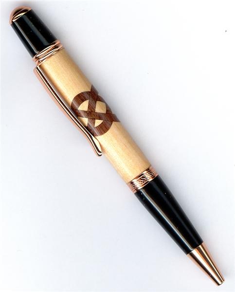

Here is my attempt at a double Celtic knot. It is made with birch and walnut with a ca finish. Please all comments welcome.

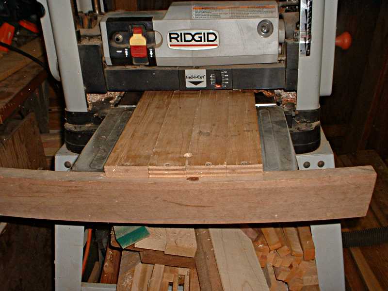

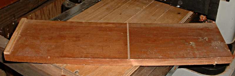

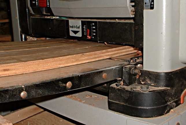

Gary, could you tell me more about your thickness planer sled? I have been trying to design one for my 12" thickness planer that likes the wood to be at least 10" long.
GaryMGg
Nov 23, 2006
5,786
McIntosh, Florida, USA.
Bill,
These sleds should give you workable solutions:
For short stuff, I use this sled or one like it. The short piece rides in the sled.
It's just a square milled piece of cherry scrap with a stop:
For longer pieces, wherein I simply need to get it thinner than normally possible:
