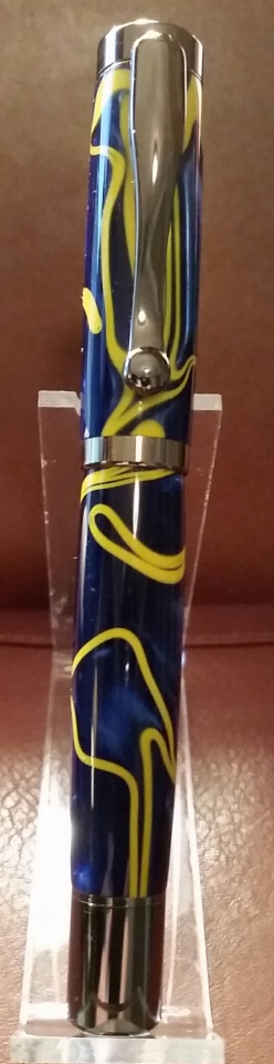

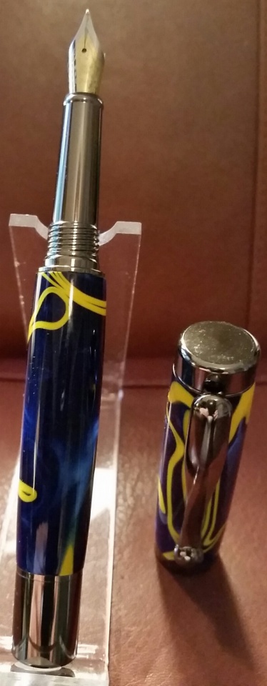

The Kyrinite turned and finished beautifully (if you see any specks..it dust not scratches LOL) .
The dang nib probably is not the best. Does anyone know of a better quality replacement. Berea simply describes them as medium nib. They volunteered to send me another one (nice folks). If it doesn't work-out, I will make it a RB. I know of the better quality brands, but I don't know what is compatible with the Atrax.
I did reverse the barrels with medium blue Krylon (and tubes).
Thanks for any advice.

Not always the nib that is the problem. It could be any number of things.
I don't think it would be fair to blame the nib or quality without troubleshooting.
A medium nib is just the tip size and has nothing to do with quality.

The first fountain I made was an Atrax as well, I messed with that nib for a long time and never got it to write very well. I replaced it with a 5mm bock nib and it writes wonderfully, I tuned it a bit after watching several youtube vids. It's one of my desk pens because it writes so nicely.

Thanks Warren and Joe. I have been trouble shooting for 90 minutes. I even replaced the nib with another Heritage or Taiwanese something nib(from one our suppliers, that did caution me BTW). The piston works, the feeder is absorbing ink, etc. It shouldn't be that complicated. I have used off the shelf FPs before. If you have an extra Bock, I will gladly buy it from you if going to WC on Saturday or the wood show. Otherwise, I may just order from Amazon now, and I will get it tomorrow. Thanks! 5 mm, right?

Yep 5mm I got it from Roy at Classic last bash I think, only got the nib, was around $11-12. I don't think I have any more but if I do I'll let you know.

Thank you. I ordered 3 all-ready. I have taken that nib in and out so many times, I will leave alone until the new nibs arrive. Thank you though and I am looking forward to meeting you!
