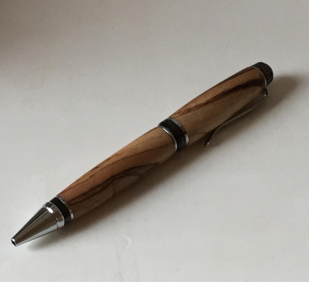

I've turned 7 or 8 pens so far - hopefully have improved a bit so far. But still MUCH more to learn. I'm learning many things with each pen; sand axially, skew chisel better than gouge, friction polish gives natural but not durable finish to name a few. The last thread I read was the $500+ pen thread. Currently my pens are probably worth less than the sum of their parts [emoji15]
I've identified that the next main thing that will improve things (as well as working a lot on the basics of turning technique) is a good way to square the blanks. PSI jig and barrel trimmers seem to get a bad rep so I think I'll go for a home made disc sander jig.
Here goes ... gentle constructive criticism welcomed.

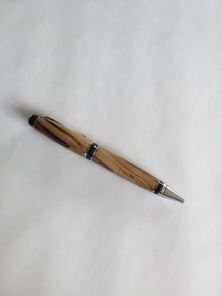

Cigar pen - spalted maple - centre band fit is dreadful - tube not straight through blank and ends squares to side of blank and not tube. Friction polish finish starting to wear after 2-3 months daily use.

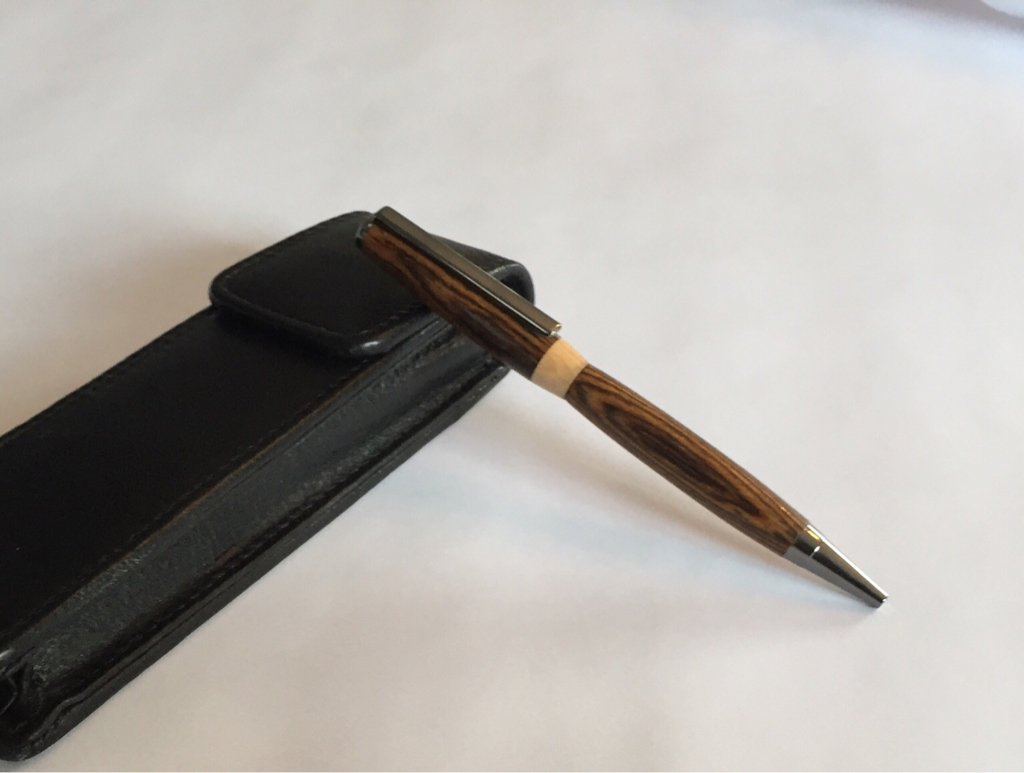

Modified slimline - Bocote with maple accent - reasonable fit. Next time will keep straighter profile on maple centre band for a more European style look.

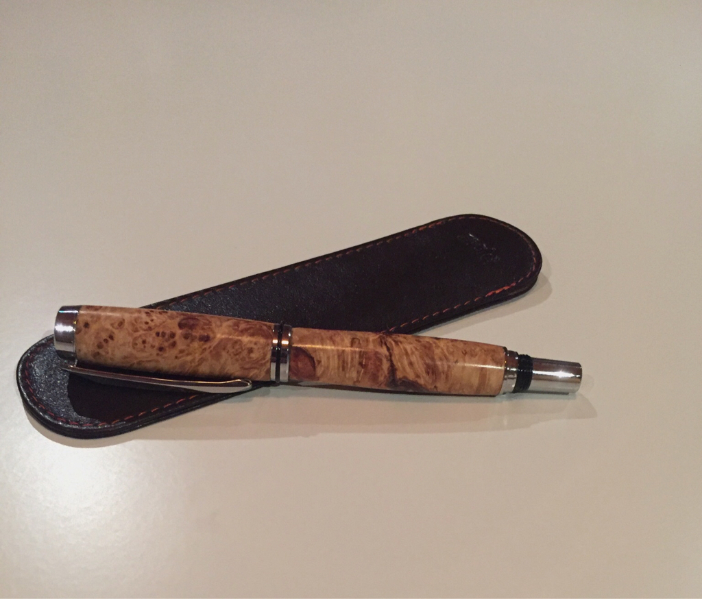

Jr Gent fountain pen - stabilised box elder burl - like the blank and the fit/profile are satisfactory I think.
Lots more room for improvement - I should have at least another 4 decades to get it right!!

The first few pens are always the worst. Your pens look pretty good.
Isn't it funny that the mistakes I make on a pen are so obvious, glaring even, to me, that I cannot understand how other people don't even see them.

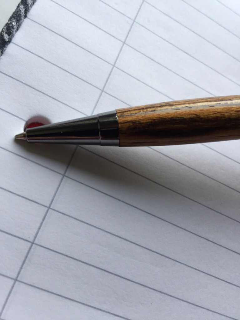

Mallory, I can not find much to provide Constructive Criticism for.
OK on one pen you have enlarged a Photograph, of the Nib End that shows, a slight oversize, But you have recognized that, and I dare say that, in the Future, you will turn and finish closer to the Bushing Dimension.
I Like what I see, and I see an Excellent Future for you in Pen Turning.
Congratulations,
Brian.

Looks like a good start going for ya.To get the best fit possible don't rely on bushings.They will get you really close most of the time but there is variation of a couple thousands with the parts sometimes.It is best to measure the parts themselves and finish to those dimentions.Some like me turn between centers one barrel at a time while others will use finishing bushings on a mandrel to do both barrels after the initial turning is done.There are probably some other ways too but I'm stuck in mine cause it works for me.
