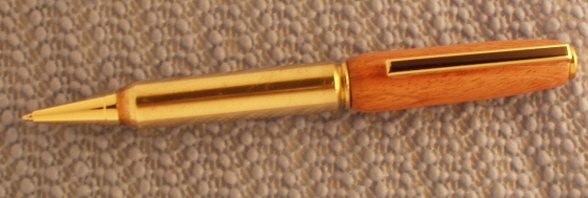

Had a unusual day at work, Snowed all day, still snowing. So, on the way home spied a Gun Shop, stopped and enquired about brass, bought some, came home and removed 12" Snow off Driveway... [xx(]
Then I designed and made this pen. [:I]

Thank you all, the idea had been bouncing back and forth. Today, was like a light bulb came on...[:D] Pure Inspiration![8D]
Oh! Kinda Snow we get means: Snow Blower, track drive, still had to use the shovel a lot...
Anthony,
An Armed Society is a Polite Society...
Bought some .270 Brass for $0.25 each. Price felt correct.
A little power sanding and reaming and drilling. Then everything lined up. Popping the spent primer, required making a tool... Then piece of cake.

John that is a neat looking pen. I have seen several Ammo pens but have yet to figure how they are made. Do you add a tube inside the shell casing? Could you share your procedure with us?

Was just trying out an idea... Stopped back to get some .06 brass. The fellow watching the store loved the pen...
John,
Sure... [8D] We're all here to learn... I used a tube as I had to take off some of the casing for the nib to match. At the other end, the tranny must be inserted into a tube. Press the Nib on the tube. Remove Spent Primer and drill end for tube. CA tube and Nib... Press tranny... Polish Brass... Turn a Normal To and Finish... [8D]

So As I read this,yours are "hollow"?

Thanks for sharing your method with us. Nice to learn something new!
