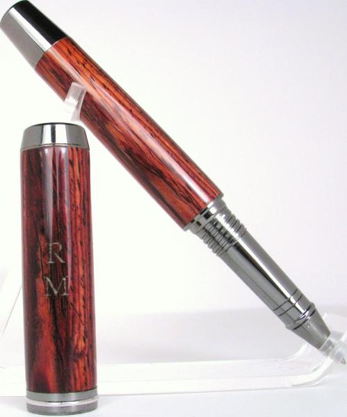

Here is a picture of a club I made from Cocobolo and then engraved. I think it will give you a good idea of how it will look with and without color fill.
http://www.penturners.org/forum/f45/martys-big-stick-75693/
I have never engraved more than 20 pens in a single order, so I don't have a jig made up that would reduce the time it takes to engrave them. In general, for a simple engraving, I can do 20 pens in 30 minutes by manually placing each pen one at a time on the single pen jig. That means 100 pens in 2.5 hours.

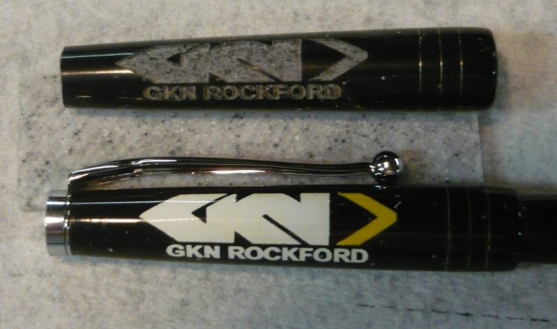

I am just finishing doing 30 pens for a company that what their logo engraved on it. The pen a slimline made out of black Corian. Here is what I have learned.
1) If possible keep away from logo's with a lot of "open" space in the logo. In other words a lot of space that needs to be engraved out. This is not a problem for the engraver but is a pain in the rear to fill.
2) Also if possible make the area that is going to be engraved as flat as possible. Not literally flat but no hump from the top of the blank to the bottom. What will happen is the engraving on the ends will be at one depth and the middle will be deeper. The main problem here is the middle area may heat up to much and possibly crack the blank. Also the deeper the engraving the more fill you will need.
3) I used paint and paint filler to fill my pens. The lettering filled fine. Logo took about 6 times to fill properly.
4) Make sure the graphic you get or make is stored in a vector format. This means eps (ecapsulated postscript) or avi -NOT- bmp, gif or jpeg.
5) Get ready to get bored. Doing 30 has taken me 2 months to do. Granted I have a full time job and at least 3 of the weekends were full with family stuff. But still, I will be so happy when I am done with this. Should be this weekend.

Sorry, I did not get a chance to post this last night, to late at the office.
I included the unfilled top along with the finished product. I will not be giving the finished pen to the customer, there is a problem with it. One of the band accents did not come all the way through.
