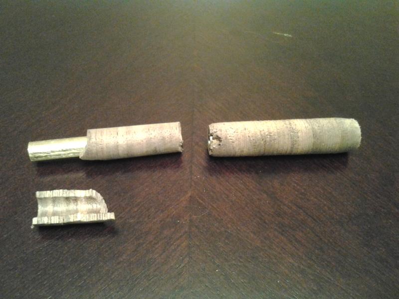

Well that didn't go as planned lol. To start I was having a tough time keeping the blanks from spinning. I don't know if I was holding tools right or if I was using the right took at the right time. Well tomorrow is a new day and a new turn hehe

New really doesn't mean sharp. When glueing in tubes I'll put a little glue in from the other side of the blank. I'll use thick CA so I have time to push the tube in and rotate, then do the same from the other side. Sometimes a spinning blank means the tube has broken loose from the blank or the tool is pushed too far into the wood. Side note CA doesn't really work with acrylic blanks. You will need to use epoxy or gorilla glue. It is also easier to blow up an acrylic blank than a wood one. Let us know how it goes tomorrow.

I would suggest watching a few of the videos on YouTube concerning turning. In particular, Capn' Eddie Castelin's is very good. Some of his suggestions are great, i.e. letting the glue cure over night, others are OK, i.e. using a twist clamp as a pen vice. I know that a lot of people use them because they are cheap, but I can't imagine essentially ruining one just to use it as a pen vice. You can buy a great one for about 30$ from Woodcraft, and it is dead simple to use, plus it fits nicely on a drill press bench.
One other suggestion, pick a blank that is generally considered hard. Black Mesquite, Cocobolo, Lacewood, are good suggestions. I wouldn't try anything super hard like Ligum Vitae or Desert Ironwood unless you have carbide tools.
As others have said, sharp tools and light cuts are essential. One last thing, have fun!!

Just my opinion but looks like your tools are not sharp. New does NOT mean sharp.
Good try, keep on practising, you'll get it.
I did file the tools before I started maybe not good enough lol
what did you glue the tube in with? Next time stick your tongue out the other side of your mouth.
I used a medium CA
So put the CA in the blank 1st? And yea I aint gonna attempt to do a acrylic til I get the wood mastered lol

Ensure that you have scruffed up the pen tube. Essentially it should not be shiny anywhere. You should then put you medium or thick CA glue on the tube. The glue should essentially cover the tube. You then need to insert it with some "speed" while spinning the wood blank a bit. This essentially spreads the glue around the inside of the blank and creates a better bond.

Thanks for the video. I already see that I was using the skew wrong lol. One other question I have is when rounding the blank should it be at a high or low speed?
WAIT JUST 1 MINUTE THERE!!! How did you get a hold of my 1st pen :confused::mad::confused:. Just kidding. :biggrin: But it looks eerily similar.

Yea I had had a little mishap :eek: lol But i will be at it again tonight after work. My wifey called me today at work and asked what I wanted for dinner and my reply was I dont have time for dinner I have a pen to turn hehehe:bananen_smilies051:

It looks like you have the wood glued on the tube "cross grain", instead of running from one end of the tube to the other. Your's is a bit trickier than typical "end-to-end" grain orientation. If you try another, try it with the grain running the length of the pen. Later you can move on to cross grain...

Ah that make sense I will do a straight cut blank tonight. DANG when is 6:30 gonna get here lol:rotfl:
High speed for rounding and turning. Some people then slow it down for sanding ( I sand at top speed). Again, sharp tools and light cuts. The 'skew' is not the easiest tool for beginners so... you might want to use something else, like a smaller spindle gouge.

I run high speed on all. If your blank spins try tightening up the nut a bit. A skew is a tough tool to master, I still rarely use one. Do all my turning with about a 1/2" gouge.
Yes, I had notice the end-grain blank used, straight away but I kept reading through to see if anyone noticed that and obviously you did so, nice catch...!
There is certainly not the best blank option to use on your first pen, anything with a angle cut, is more difficult to work with and more fragile in all aspects of the pen making, starting with the drilling...!
There is nothing to worry about and any improvement that can me made on the tube gluing, will also minimise the risks of a blow-out...!
Straight cut (with the grain) "solid wood blanks, are my recommendation at this point, leave all the soft woods, woods cut in angles and even the acrylics alone, a regular wood blank is a lot cheaper to replace than a acrylic one...!
