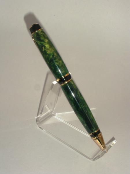

I finally tried casting for the first time the other day and got around to turning it tonight. I think it went pretty well for my first attempt and I learned some things that I am sure will make the next one better. It is supposed to be green with gold swirls. The green came out how I wanted but the gold swirls aren't as noticable as I had hoped. I should have let the resin set up a little longer before I swirled the colors. Anyway on to the pics. Thanks for looking.

Looks Good Jamie!:biggrin: I think my first cast ended up in the dust bin.:eek:
Yeah I was a little afraid that is where mine would end up when I finally started mixing the resin. My only real goal on my first attempt was to be able to make a finished pen out of it. I was able to do that and I think it looks pretty decent too.:)

I think it looks good Jamie . Didn't know you were into this mfg. stuff . I'm looking forward to seeing more . Nice pen !

My first cast, and 2nd, and 3rd ended up in the trash, so you are doing great.
I like the green and gold motif as well. Keep up the good work.

very nice.... especially for your first go at it. I like the colors you chose and the swirl effect you achieved is subtle but attractive. keep posting your pics.
Oh yeah, the pen looks very nice as well.

I like it a lot. The swirls are just enough to set it off. I like the green too.
That's a very nice pen.

Looks like you've been at it for some time, I think it came out beautiful.

Jamie you did good for the first time and it does become addictive somewhat. Just a note though when using the resin, either wear some protective mask or do it in a well vented area. That stuff can give you a headache. Also depending on how you are doing the casting, if you are making a block or just one at a time., it would be better to buy some ready made molds. You really are not saving anything. That green is a nice color. Maybe add a little black for the secondary color or even white. Keep up the good work and thanks for showing.
