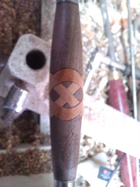

After seeing the previous threads on Celtic knots I decided to give it a try on some scrap.I read all the tutorials and put everything I learned to work.Made up a jig for my table saw and come up with this knot.Its in some scrap and wont be made into a pen.I have a couple of adjustments to make but I think it turned out well for a first.

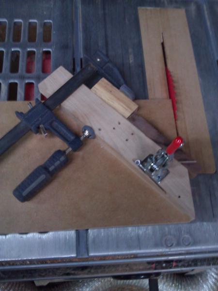

Here is the jig I made out of some scrap I had lying around.Its not the best but it does work.I will be making a better one when I get better materials.I went to Home Depot yesterday and a Diablo 7 1/4 inch 40 tooth blade for on the saw.The kerf is .062 which is much thinner than my other blades.Thanks for all of the tips.

Here is the jig.Its made of 1/4" mdf bottom with 3/4 x 2" maple fence.On my next one I want to make it where the fence is adjustable for the angle.

Randy,
I did see that before & it looks very functional. How is yours different/better. I will probably build one this weekend. Is there anything you wish you had done different with that old 20/20 hindsight? :biggrin:
The newer version uses two miter slots for the base. The fence, threaded rod, and hold-down are separate and can be adjusted for different angles. I'm still experimenting with differing positions for the base and plate.

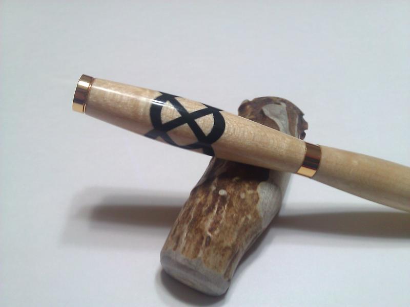

Here's the second attempt at the Celtic Knot.Its maple with black kydex for the inlay.
