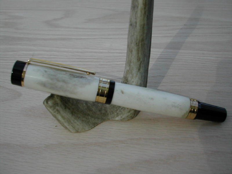

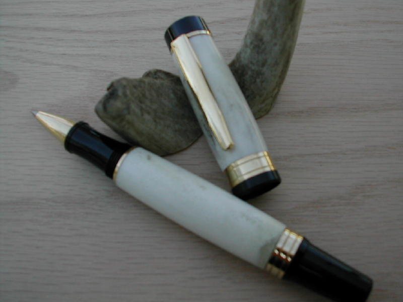

I got my shipment of antlers from Bill and this is my first attempt at turning antler. It's an El Grande.

The kit sets off the antler well!
How did you like working with the antler?

Good Job! It looks great! Have you got the smell of antler out of your nose yet?

Nice looking pen. I have never turned antler myself but I have read here that it SMELLLLLSSSS! How did you find the odour?

Thanks for all of the comments. I appreciate them. For a first time material it went OK. Kind of hard to drill something that is not straight, but managed. It turned better than I thought it would, no chip out and no catches. As far as the smell, I wore a respirator and kept a DC on while turning, so no problems there. Overall experience in my opinion was good and plan on turning a few more.
One question I have is, has anyone had a antler pen laser engraved? How does it do?
