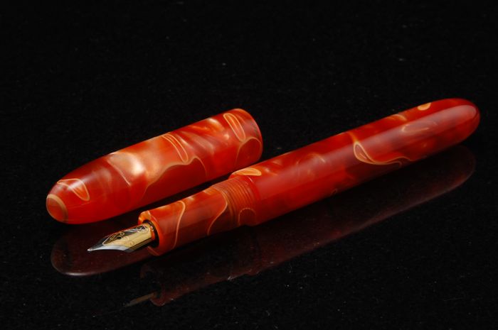

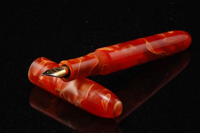

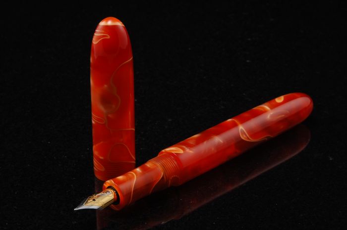

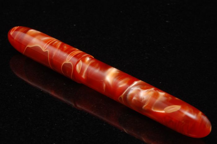

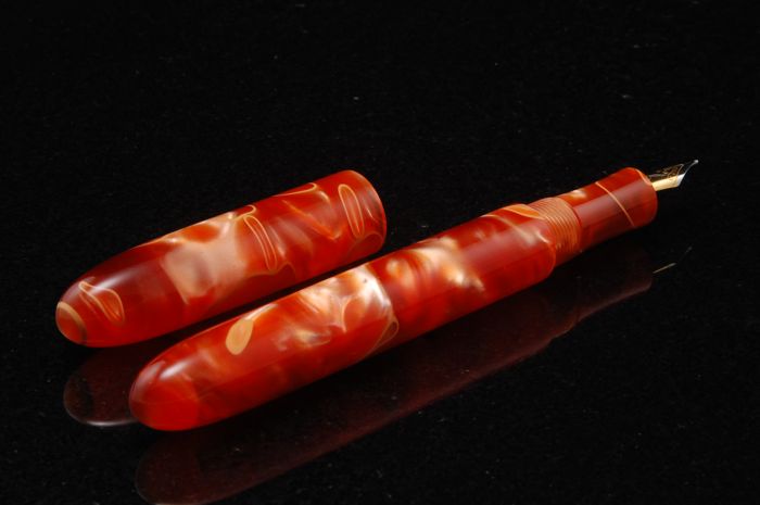

Her is a pen I made a while back, just havent had a good lens to take some pics..........Well thanks to our resident Wizard(Doc) i have a new lens and he gave me some photo tips.:biggrin: This is Lucite with a Heritance feed and nib.
All comments Welcome
Thanks For Looking
Justin

Very nice Justin. Photos and everything.
This is not a critique on the pen but a kitless question.
Have you tried recessing the threads in the cap and putting another smaller diameter on the body of the pen behind the threads that is the same depth of the recess so that the body and the cap end up the same outside diameter? Hope that makes sense.

Thanks Mike! I havent tried that yet, but there is also no reason why i couldnt just make the body larger to match the cap. It would make the transition to the threads a little larger, but that step you see inst very big. The cap is around .625" in diameter and the body is around .55 in diameter, so they arent far off. I dont think the step and recess is needed, and dont think there would be enough room in the cap to do it at this diameter, but some also use this as a stop for the cap. The cap stops just fine when the two pieces come together, so i still dont see the need for it. This is just the design i have been making lately where the cap is a little bit larger the the body. I have about 4 of these so far, just need to post the pics.:biggrin:
Thanks Again

Absolutely beautiful pen Justin! Simple elegance. Nice work! I don't see a clip on this one, unless it is hiding on the other side of the cap. It would look great with or without a clip.

I had not thought about that as a stop, as it has not been an issue with the couple I have made. I could not tell in the photos if the cap could be made smaller or not. I think more than anything I was looking for more design options from the basic layout. I still need to get to your point of accomplishments :redface: to get to the point of trying the things I see in my head. Man is that a scary thought. :eek:

Like I said at the Central Texas meeting Justin after seeing your pens in person, you do awesome kitless work.
I kind of like the way your design of the cap being just slightly larger than the lower body. It has an appealing look to it in person. It just looks right.

As a person who uses one of Justin's pens, I like the design for several reasons which include both appearance and function. First, I think esthetically it looks more pleasing to the eye with the cap being slightly larger. I personally don't really like a pen that looks like a missile. Justin painstakingly aligns and has threads started so the patterns line up on cap and body. By doing that, the small difference in diameters of the cap and barrel are further camouflaged. Moreover, I really like the pen sans the centerband as the pattern is not interrupted along the length of the pen. Second is a more practical reason, particularly when the pen is without a clip. When I pull the pen out of my coat pocket to write with, I immediately know the orientation of the pen so I don't have to look down at my pen and break eye contact with a patient.
I write with Justin's pen in patient charts anywhere from 6 to 10 hours a day and I can use it comfortably. The section is perfectly contoured for my grip. The transition between the threaded area and the step down to the section is not even noticeable to the fingers. Because the section is of sufficient size and area so that further back your fingers are no longer even in contact with the threaded area or ledge between the body and threads.
Some, not all, high end pen companies seem to design their pens with esthetics more than ergonomics in mind. The pen I used prior to Justin's was a Caran d'Ache with a hexagonal barrel in which the body and cap were of the same diameter. To keep the diameter the same, the section is smaller and less comfortable to use in my hands. After hours of use my fingers would cramp. I prefer to write with Justin's because of the comfort and esthetics of a custom pen .....and because it was a birthday gift:wink:. I'm probably biased, but truly believe Justin has great potential to push the limits of advanced pen making to new heights.
That's just my two cents worth...

I think if the cap was the same diameter of the body it might disrupt the flow of the pen, at least with acrylics and other materials that have an obvious pattern. In other words, the "grain" won't match up. If the cap has a larger dia. then your mind recognizes that there is a cap there and your brain more easily accepts that the "grain" doesn't lie up. I hope this make sense. This is a fantastic pen by the way ! :biggrin:

Tyler - you are correct when dealing with a pattern between cap and body. What about a black body and a patterned cap or vise versa?

That might look cool. If I knew how to make a kitless pen I would try it. I think if it had a patterned body and a black cap it would need a clip to aestheticly balance the pen. Someone should try doing this...
