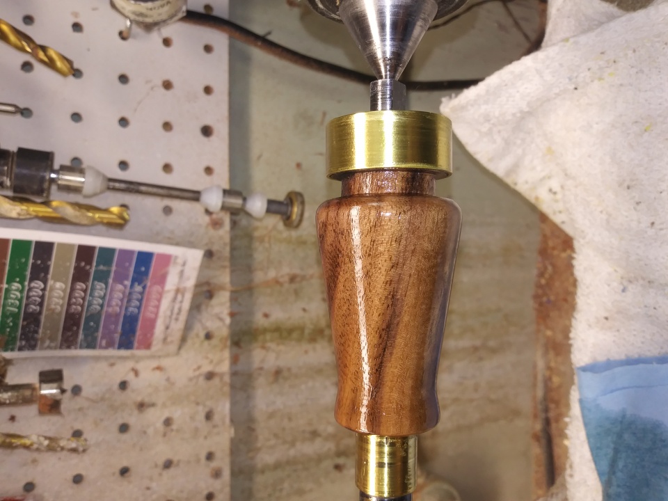

This is walnut with 7 coats of clear fast drying Poly. Walnut
