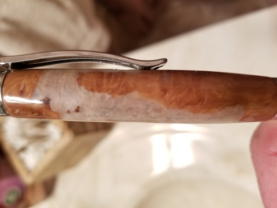

Hey gang I'm looking for suggestions on finishing brown mallee burl. The first pen I made looked great but after 2 weeks the CA is separating off in huge bubbles. I'm sure it's due to the oil in the wood but what other options are there for a good shinny durabnle finish?

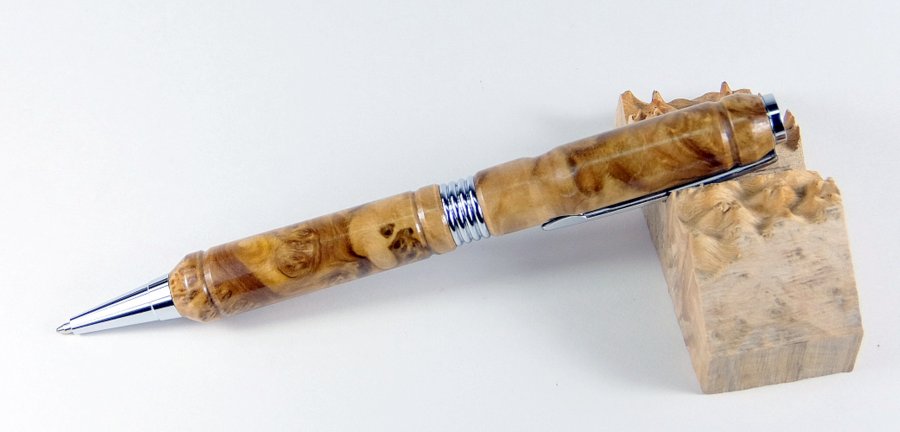

Had a quick look back in my album, This is Brown Mallee Burl resting on an offcut of Brown Mallee.

Peter, thanks for posting in this thread and also for the picture of your pen.
That pen is exquisite !! . But you didn't even tell us how you finished it !!
Please ..... !!
Please ..... !!
Its a number of years ago but light papered to 800 grit, two coats of CA. The fact the blank included Sapwood appealed to me. This blank came from South Australia where this Mallee excells in colour.
Just one coat of CA takes a devil of removing so I know two coats is plenty,no finishing after this.

Jeremymc98
Dec 4, 2017
107
Lexington, KY
Thanks for the advice guys.. I don't was my blanks before finishing with CA so I am not sure what happened. My typical process is 3 coats of thin then 3-5 coats of medium. MM to 12000 then Hut polish a few times. The bubbles are growing and look like old icing breaking away from a delicious Krispy Kreme doughnut.
Can it be sanded off and refinished or more problem than it's worth?

coffeeslug
Apr 20, 2017
23
Chicago
Not 100% sure but it sounds like the wood might have too much moisture left in it. CA reacts to excess moisture and oil in unusual ways like this. It also reacts to temperature strangely.
I would try sanding it all off (a pain, i know) and re-applying the CA. Unfortunately, sanding to this point may take off precious width that you need for the pen components and cause the diameter to be off. You may be able to balance this with extra coats of CA though.

Jeremy,
No one can know what you are actually doing but you. Sanding and applying finish are pure 100% subjective to the individual. How one person interprets the pressure and application is subjective. A 250-300 lb person will use light pressure (to them) in sanding at a much more pressure than a 140 lb person who claims to use heavy pressure.
The point is - you are having problems. Bubbles. You are using 3 coats of thin and 3 - 5 coats of medium. If 5 different people did exactly that, AND the blank was measured BEFORE any finish were applied, and then, the blank was measured AFTER the 6 to 8 coats were applied - you would have 5 different thickness measurements.
The only way to really determine is with measuring with calipers before and after. a point zero zero five (.005) build up is exactly that. And starting with 1200 MM and progressing through to 12000 will build up a film that will be just over microns thick. Added to that the wax will add a layer or two. I would re-think and ask if that is the Hut polish bubbling off. I have seen that and I have experienced that, and I deliberately got away from Hut polish for that reason. Then I learned that my idea of sanding was different from reality/actuality - after I got a good set of calipers and let the calipers determine how much CA was actually on it BEFORE adding wax/polish.

Here's a pic of what happened after a 2 weeks or just sitting
Did you add or apply the wax/polish on it before applying CA? Did you put BLO on it before CA? BLO doesn't usually do that but if it is put on and not "burnished" in before adding CA, that "could" happen.
That looks like CA "lift" that occurs on the ends of some finished "oily wood" blanks. That also happens when CA is just as thick on the bushing as on the blank, then when separating the bushing from the blank, the breaking off of the bushing causes the lifting, and it happens more on oily blanks. This is because the CA doesn't stick well to unprepared oily blanks. The Mallee is not that oily in my experience.
Another question: Did you put denatured alcohol on it? Did you do this in cold or humid weather?
Did you have it sitting on a desk in which sunlight came in and shined on it for a few hours at a time, probably over a few days? That is another possibility and sunlight even in a cool room does strange things to wood under glass or protectants.
Sorry for the questions, just trying to find a connection for that.
1080Wayne
Feb 5, 2006
3,344
Brownfield, Alberta, Canada.
The regularity of the boundaries are typical of a sanding operation on wood that is not uniformly hard , so Hank`s question on whether there was a pre-coat of anything oily or waxy that was subsequently sanded off is pertinent . Which also leads to the question of the type of sandpaper you used . Some are stearate coated . I don`t use them , but it may be remotely possible that it might interfere with CA adhesion .
Last question would be , has the affected area grown since you first noticed it .
PatrickR
Apr 8, 2017
1,433
Rural America
Definitely an adhesion issue. One of the following.
Contamination (clean the blank with da between sanding grits and before finishing, allow to dry fully before using CA)
Bad CA (replace it)
Wood not fully dry or reached equilibrium for your climate before you started (weigh the blank when you get it, check it periodically)
Sanding too fine before finishing (polished wood has no tooth to hold the finish)
Good luck with the next one.
