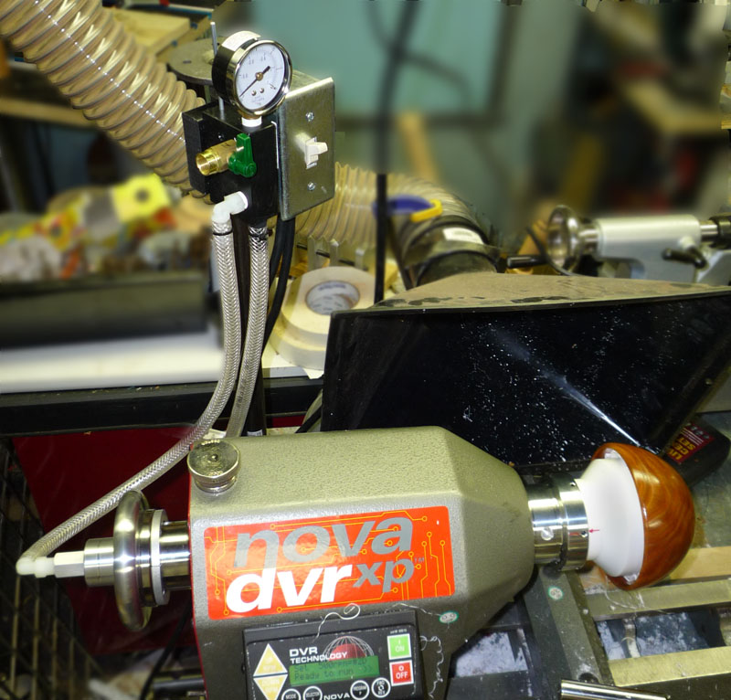

I started with jam chucks and they worked fine
Then I switched to Jumbo Jaws for my Oneway chucks (like the Nova Cole jaws)
Finally I installed a vacuum system... it changes they way one looks at workholding. Here's my setup with photo and notes.
